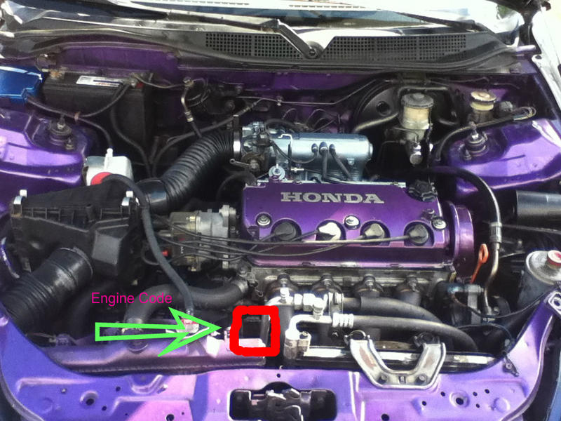

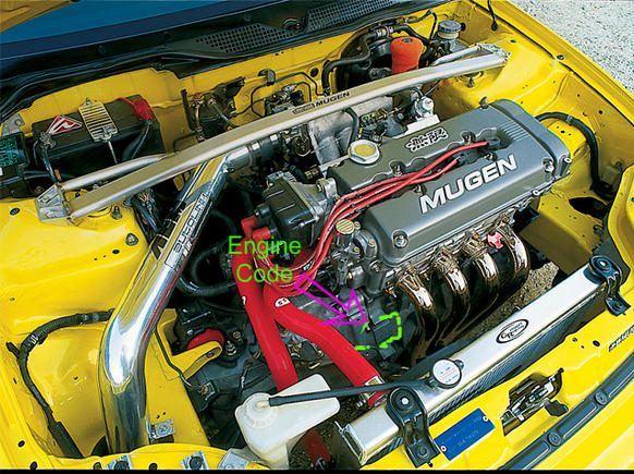

SOHC

DOHC

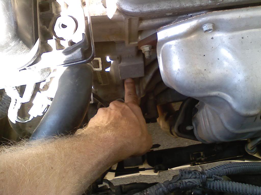

Originally Posted by 96vtech
where would that be located????
Right on the front of the block. Between the exhaust manifold and radiator hose.
