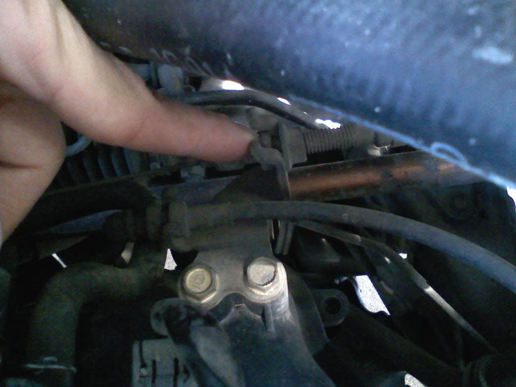

This is a pic of my '01 NOT a '96, but yours should look about the same. Check freeplay up near the throttle body about where my finger is:

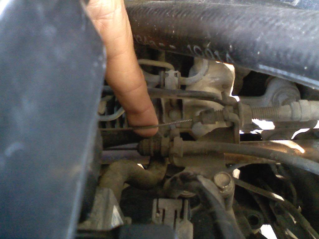

4. If freeplay is out of spec, loosen the locknut:
5. Then turn the adjusting nut until it in spec:
