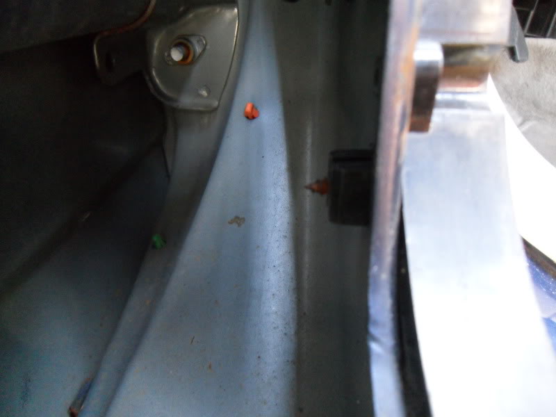

as promised, pictures
Got a spacer kit necessary to fit deeper speakers (I'm running alpine type-r's, SPR-17C). Max allowable depth without the spacer is 1.75, I believe. The depth of these speakers are 2.5". If you look at the rust (yes, I know I need to fix that.. lol), that's where I dremeled out to fit the speaker.
The spacer fits in the clip-holes (I guess you'd call them) in the OEM locations. 2 clips on the bottom and 1 screw up top.
Get creative with it, man
