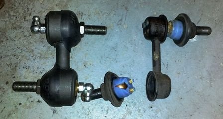

If your endlinks are broken, then yeah, you should replace 'em. I'd also replace them if there's noticeable excessive play in them (grab the shaft and shake it like you're trying to wiggle it loose).
If the rubber boot is torn, maybe consider replacing them. Dirt and crap can make them wear out faster.
If the rubber boot shows signs of cracking or something, keep an eye on 'em.
Took this picture from google images. It's from a 2004 Subaru Impreza, but it gets the point across, and the 7thgen uses similar ones (if not the same ones. I don't remember)
Endlink on the right is clearly broken. Little ball joint came out of the main body of the endlink. I've also seen pictures of that bar on the main body snapped, but usually when people install beefier sway bars on stock endlinks.
With a broken end link, you may notice rattling/metal on metal sounds of the sway bar hitting crap. You'll also notice more body roll up front and some decreased understeer.
