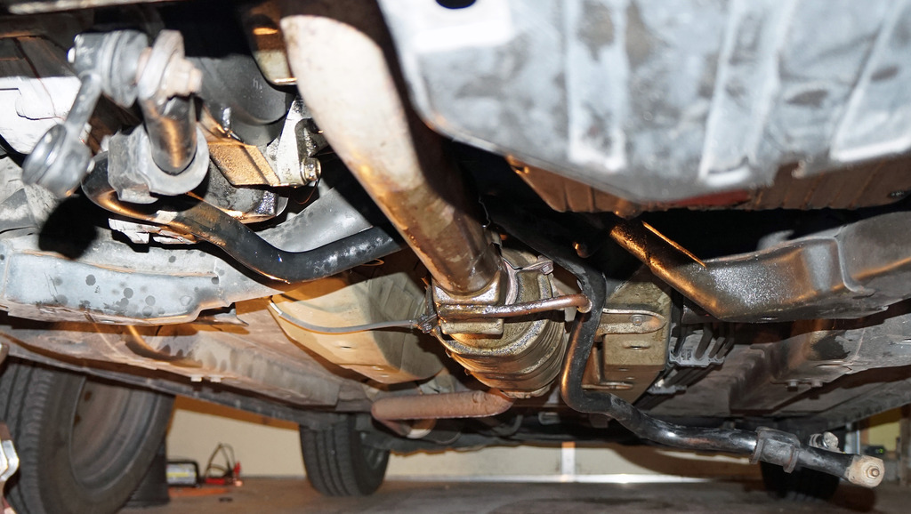

as additional information, yes, the bar comes off an EX without removing the exhaust too.
EX exhaust anti roll bar - put bar closer to the cat, turn one end of the bar to the back, twist and it's off!
I personally just removed the bar altogether. Better handling, no more understeer, lighter front.
If you look at the endlink that is closer, you will notice it is broken. Ran for months and it's better, indeed.
Keep in mind I run Eibach pro springs and KYB AGX, with rear progress anti roll bar.
