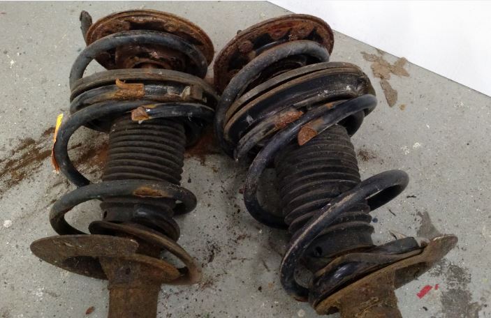

normally what happens is the bearing(which makes the strut rotate as the wheel turns left and right) on the top of the strut fails, initially you hear clicking and clanging, then one day when you turn the wheel, the springs crack off and the noise it makes gets scarier. i would replace the entire assemblies on both sides.
i dealt with that recently on a malibu. these are what came out:
notice how both springs are cracked in half
also had about 50 little bb's roll around the floor from the bearing cup on top.

That picture gives me anxiety
