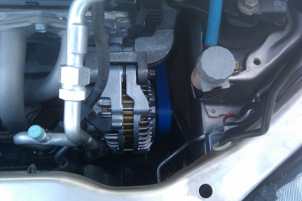

Took my power steering out / installed a breather. Half the effort, than just removing the belt. Couldn't be happier. A little more time and money is involved, however.
Name:	PS Delete.jpg
