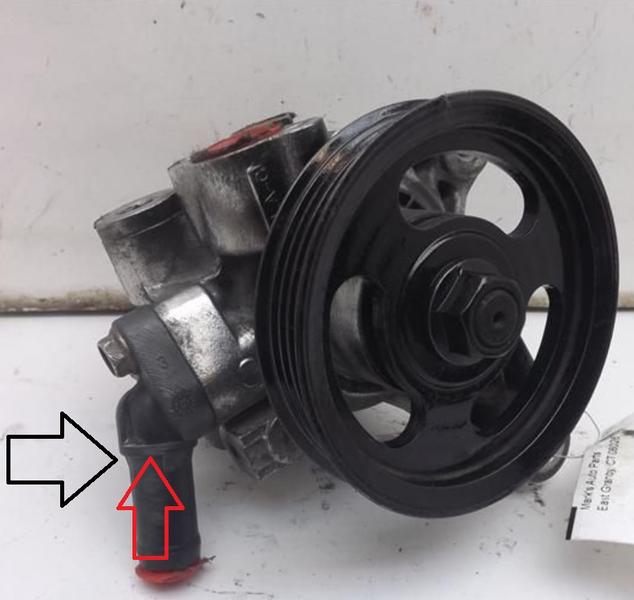

Hey Guys,
Been crazy busy at work....
I was changing a leaking suction line on my 03 and I guess it was either time for it to fail or I was he-maning it too much.
I broke the plastic knuckle where you hookup to the power steering pump to resevor.
I was wondering if anyone had a part number or name of it to search at the parts stores, went to two salvage yards and they only want to sell me the pump...
Black Arrow points to the part
Red Arrow points to where I busted it.
Picture compliments of ebay...

Re: Power steering suction line part name or PN needed
http://www.hondapartsnow.com/parts-l...p-bracket.html
#3 ??
Old Mar 29, 2015
Be sure to get the O ring #20 with it!
Many many thanks! Calling my local honda dealer in the morning for number 3 and 20
Can't wait to get the ole girl back on the road
