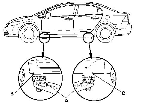

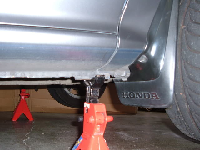

Old Dec 24, 2013
Rep Power: 518
Re: Troubleshooting engine bay noise... SoS
Originally Posted by IMeanNoAssets
Yeah, I thought about those sides but honestly, they don't look too trustworthy... hehe.
The reinforced tabs on the pinch seam lip on each side are where you are supposed to jack the car.
