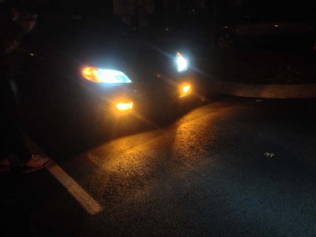

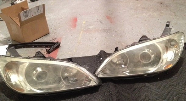

As promised...
Here are the photos. I got the project done a month ago, but wanted to restore my headlights first before taking any photos.
And by the time the Pittman Original OneStep ALR arrived it was today, and it was worth the wait.
The formula is non abrasive, very strong, and one drop cleans one headlight of oxidation.
If anyone is interested in a safe way to clean headlights, pay this website a visit. Its LEGIT
http://pittmanautocare.com/alr.html
**In the last photo, you can only see one headlight, thats because the left headlight had condensation form opening up and the glue did not reseal all the way, hence once I cleaned the outer lens with Pittman ALR, I had fog from the inside of the left headlight in the last photo, so I decided to leave it out.
But the cleaner stuff really worked. And it came with a Pittman VaporWax conditioning formula to wax the headlight.

Came out nice.
Not sure I completely agree with the pitman cleaner. My turtle wax kit was "safe" to me.
