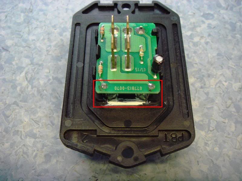

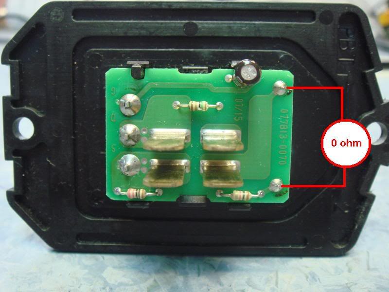

It may pass the resistance test, but the open thermal fuse will stop the blower from receiving any ground when the transistor is turned on.
There isn't any desoldering to take the power transistor apart, simply remove it from the blower housing and pop the plastic shell apart. Ohm check the thermal fuse, it will likely be open circuit.
I think it's actually faster (for me) to do this than to find the books and follow procedures, if you can get the screws out quickly. (I see the exact same failure every time.) It got even quicker after I cobbled up a "repaired" unit just to test with.

It's actually the responsibility of the HVAC control unit since it looks for a feedback signal from the power transistor and has control over the AC clutch request......but that's not very relevant right now. You bypassed the power transistor.
I gather that this check doesn't require any unsoldering.
Pics below are from this link: http://www.hondaaccordforum.com/foru...-repair-40796/
