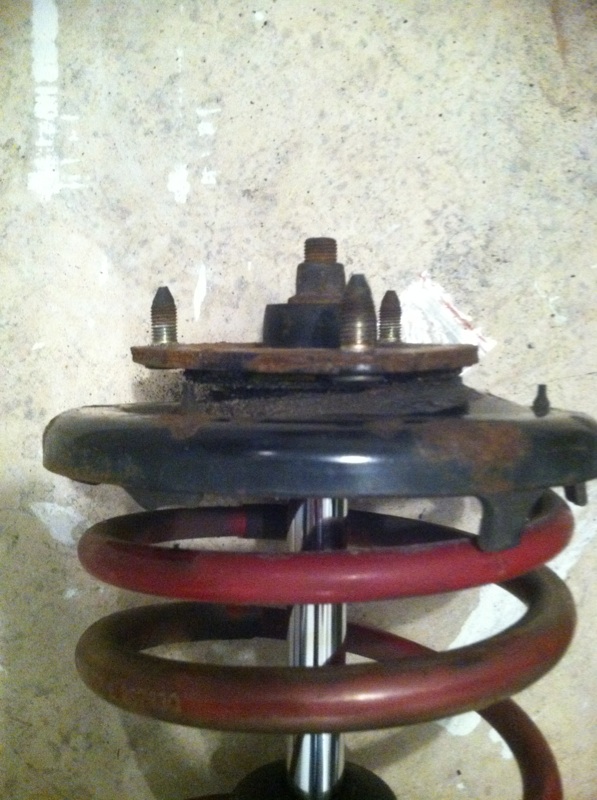

Ill take a look at my 01 struts I have in the basement. They are still assembled with Sportlines.

Thanks, would it be possible for you to post a couple pics just so I can compare?
I have a feeling that ezone's suggestion could be the problem-with the spring hats hitting the body. I don't see what else there is left that could cause this since I didn't have any noises before I changed suspension so I wouldn't think other components would suddenly show that they're bad. I didn't get outside yesterday (crazy hot) but maybe tonight I can get out there and have someone turn the wheel while I stick something between the top hat and the strut tower to see if it hits.

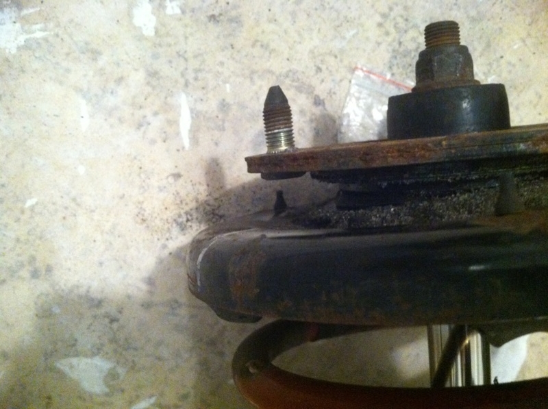

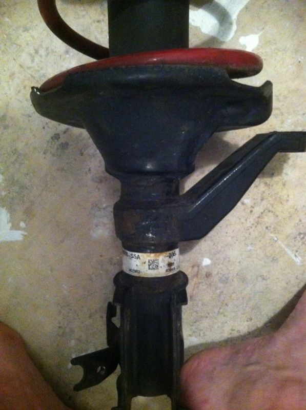

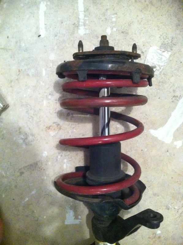

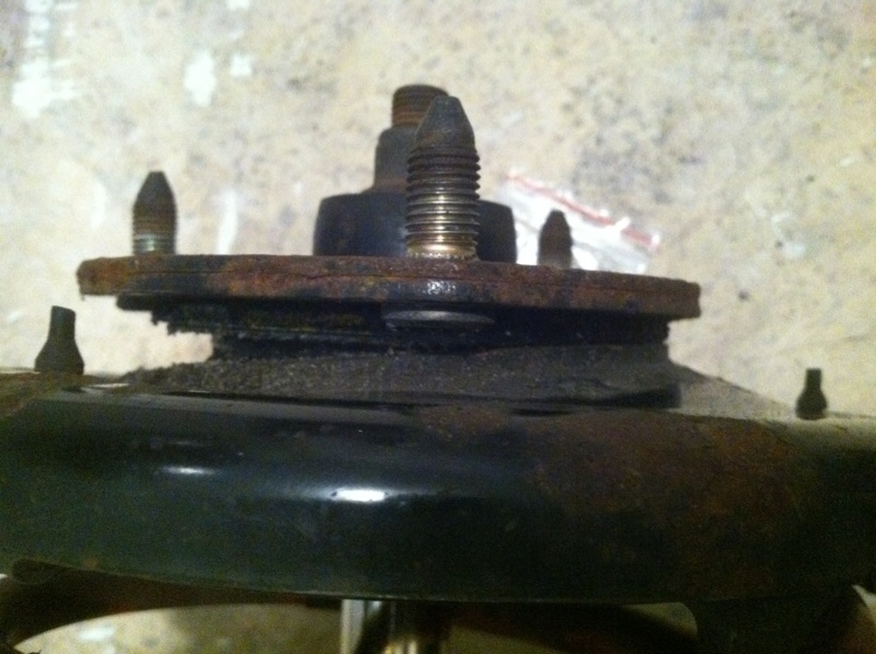

Here are some pics. Let me know if you need more or have a question:

Thanks for the pics-everything looks like mine :/ I had a friend tug on the spring while I was sitting in the car and it was the exact same noise I hear while I'm driving so I'm pretty sure it's the culprit. The spring doesn't spin, it actually pops laterally out of position, or outwards and inwards. After popping it a few times with the wheel straight, it will no longer be movable but if the wheels are turned it is easier to pop it and doesn't get "set" in its spot.
What I don't know--whether the spring is moving in the bottom perch, top perch, or if the perch is moving around on the bearing. I don't have time to look at it tonight but I should be able to spend a little bit of time on Friday if it doesn't rain constantly.
