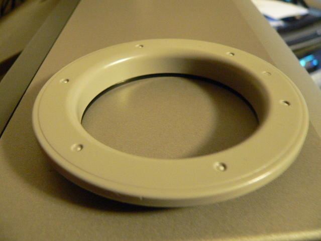

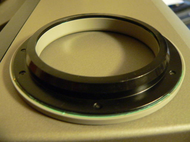

they look like this. i have spares because these plastic ones are prone to breaking that's why they switched to metal bearings. you should always replace your bearings and top hats when replacing struts mainly because of things like you described also because there cheap to replace.

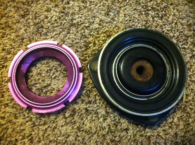

Sounds like the bearing, it sits in the top mount:
Top mount is right item. If you flip it upside down the bearing falls out and that's the part that goes bad.
**lowlifes pics are better

Sounds like it might be upside down. Using lowlifes pics the black part should be towards the spring and the white part should be touching the top mount.
If its metal then the rubber side should be facing the springs and metal side touching the top mount.

The white part should touch the mount (the thing with 3 posts for bolts).
I couldn't remember if you had plastic or metal bearings. The metal bearings have rubber on one side. The plastic ones have plastic on both sides.
