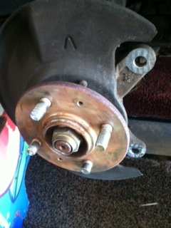

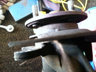

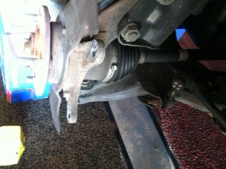

I snapped off 3 out of 4 lug nuts from the front driver side studs. Based on help from Gearbox and others, I took off the brakes and rotors. I attached pictures where I am now. Please help! From where I am now, there still is not enough clearance to get the studs out. I am guessing that I have to take off the nut in the center, but I don't know the size OR whether or not it will mess up areas that I will have problems putting back together. What are the final steps, please? I feel confident doing what I did, but don't want to get in over my head?
In short, based on the pics, what are my next steps / advice? Most things are closed today (Thanksgiving) and I don't have the option of taking the car to the dealer since 3 out of 4 lugs are snapped.
Thanks for any advice!
JEFF

thats because you need a hub puller to do the job.
it pulls your hub out and THEN you need a hydraulic press to press out the old studs and press in the new ones.
this isnt a novice kind of job fyi. it requires more mature tools than the ones found in your ordinary household.

Do you think getting the correct socket (32 mm, I think), taking off the axle nut, and pulling off the hub would work? I have replaced studs/lugs on the drums in the rear of the car.
Thanks!!

Um, I do exactly that to remove the studs.
I use greased washers and a standard nut to draw the stud into the hole.
If there is insufficient clearance:
To remove the old, I can chop off any part of the bad stud to get it out.
To install, I can grind a section of the wide part of the stud off to clear the casting of the knuckle. There is a limit to how much material I am willing to remove though. I don't like to remove more than enough to make a flat on one side, maybe 25%.
One of these years I need to drag my knuckles into the 21st century and make videos of some of the things I do.
OP: Pull the whole knuckle off and carry it to a machine shop, or to someone that has a hydraulic press.

When I snapped my lugs I took it to a guy I know and he just chopped off the broken studs, ground down the new ones, and put them in.

Removing the nut (32 mm) will only remove the axle from the hub, it will not free the hub from the bearing. I would recommend you remove the knuckle and take it to a repair shop. There is not sufficient space to hammer them out unless you can cut parts of them off. A repair shop should be able to do that for you.

Good find. That's pretty much what I do if there is sufficient room.
A hammer is just a simple swing press:
Hydraulic press if the hub needs to come out, but it CAN be hammered out if one has something appropriate (drift) to beat on. You cannot beat directly on the hub, it will get deformed.
One guy I work with does this every time a wheel bearing needs replaced, because that is how he learned to do it, but: "What has been learned cannot be unlearned."
Some people can go to great lengths to make things more difficult that they need to be. He is one of them. He learned it this way, now he will never ever use a press to push the hub out.
I seriously think that if he had learned the Earth was flat, it could never ever be round, no matter what.
I have also cut a slice in a knuckle in order to do studs too, but that was a screwy deal.
