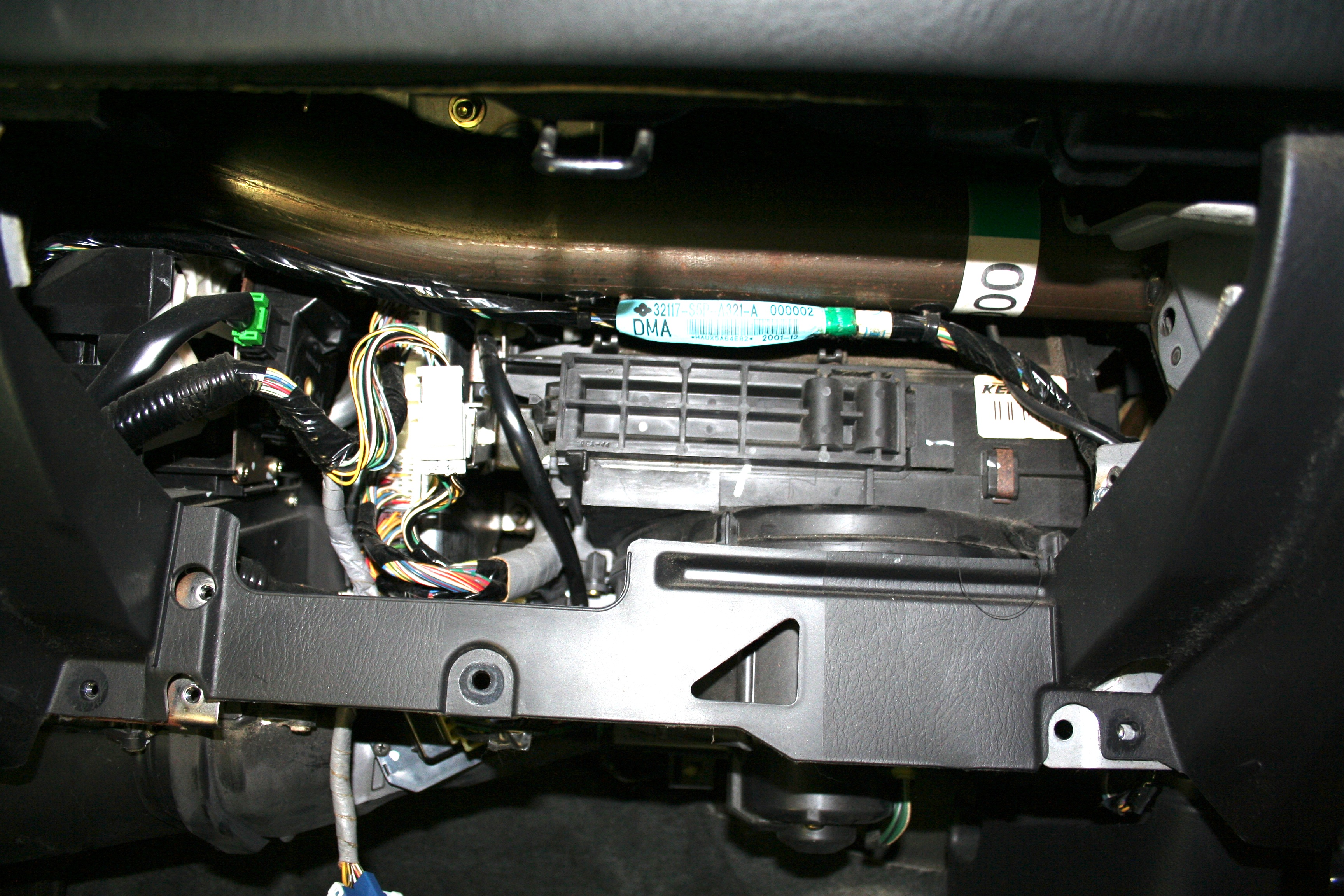

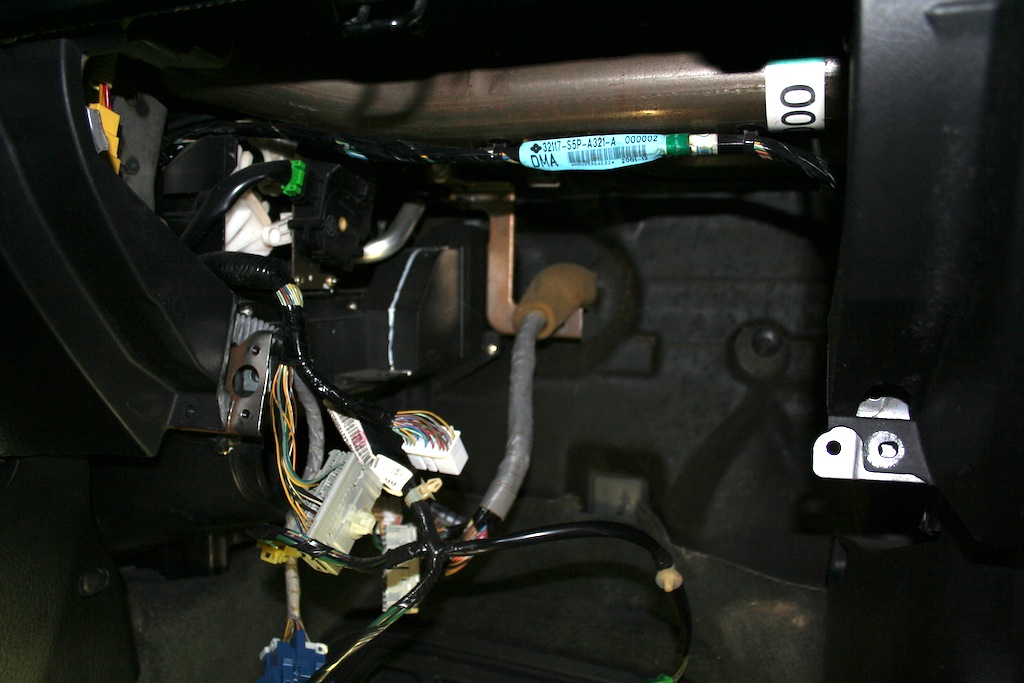

ok, hang on let me get a pic of where I'm at.
Ok, here it is. Is cutting that plastic piece avoidable?
Old Dec 9, 2012
Re: 2005 Civic Blower Motor Replacement
Nope. The blower housing will not come out from under the dash until you cut that cross section and remove the metal cross brace that it covers.
There may be a faint line on each side to cut on. If not, just chop along each edge of the large flat area. The glovebox will hide it once it is reinstalled.
You should see behind the plastic a bolt(s) on each side that holds the metal brace together.
Nothing new, Honda has done this for a long time.

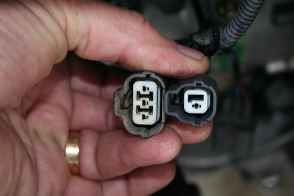

Ok, I'll give it a go. I got one more snag. I'm sure I can figure this one out, but I do have a question about it.
The plug on the left is on the oem compressor (I'll cut it off and put on the new one). The one on right is on the replacement compressor. With a meter I can determine witch wire is the trigger. What I'd like to know is what the other two wires are for.
Old Dec 9, 2012
Don't cut it off, you may have the wrong compressor.
The 2 extra wires are for the thermal protector which should be mounted on the compressor. If that isn't in the circuit, the whole mess won't work.
Early cars have it wired different from later cars. 01 used the single wire. 02-05 uses 3 wires. Don't cut it. Get the right parts.
