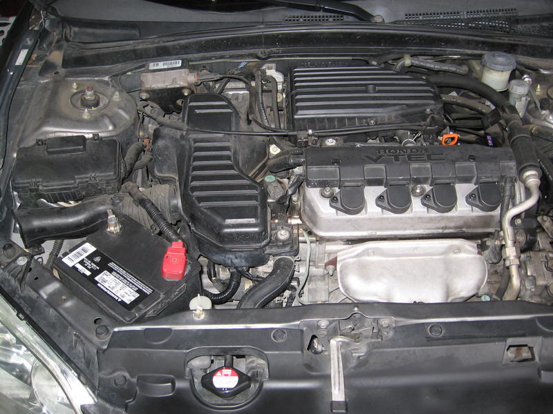

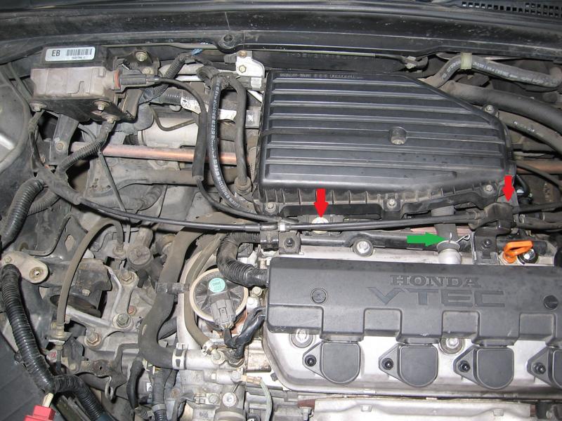

This DIY shows how to install a cold air intake on your 01-05 Civic in 6 easy steps. You will need the following tools: a ratchet, a 10mm socket, a 10 inches socket extension, a jack and a jackstand. Figure 1 shows how the engine bay looks like with the stock air intake before the installation.

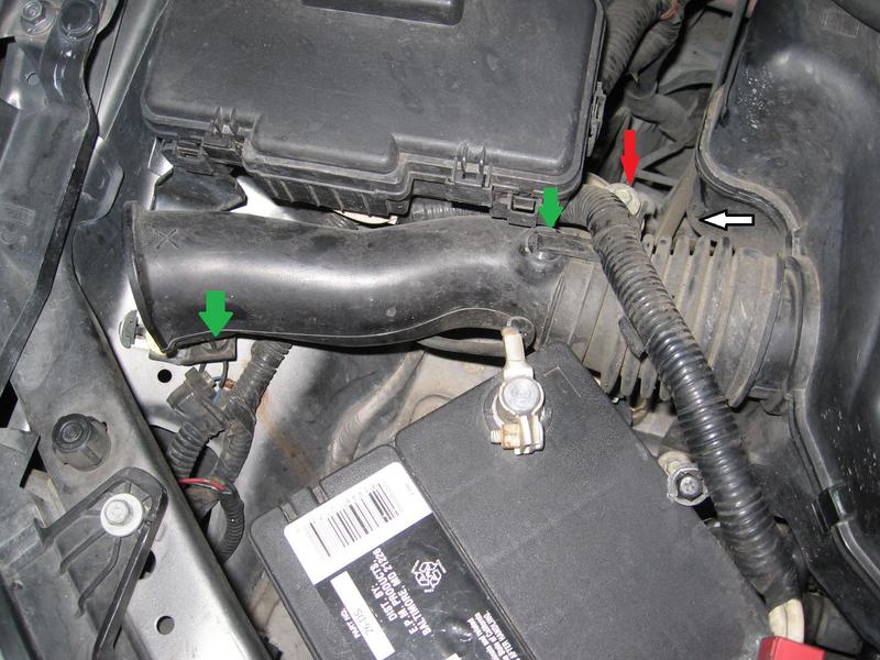

remove the air inlet duct as shown in Figure2 by removing the 10mm bolt (red arrow) and pulling out the two two rubber pins (green arrows) from the air inlet duct, then pulling the air inlet duct to the left off the intake resonator

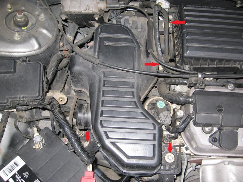

remove the two 10mm bolts (red arrows) that hold the air filter housing in place, then losen the clamp (green arrow) and pull off the hose that go into the valve cover as shown in Figure4.

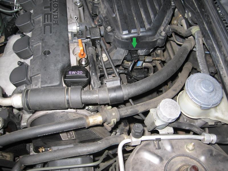

disconnect the connector (green arrow) that goes into the air temperature sensor as shown in Figure5, then pull the air temperature sensor out of the air filter housing.

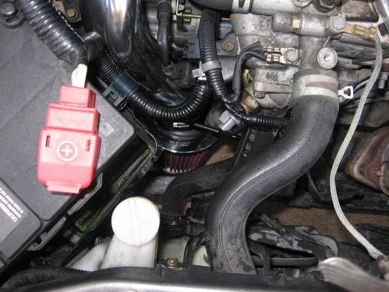

Jack up the car and slide under it to install the air filter into the outlet of the second pipe as shown in Figure8. You may need to readjust the two pipes to fit the air filter in there.

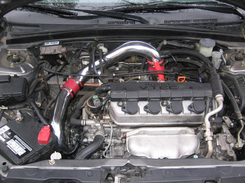

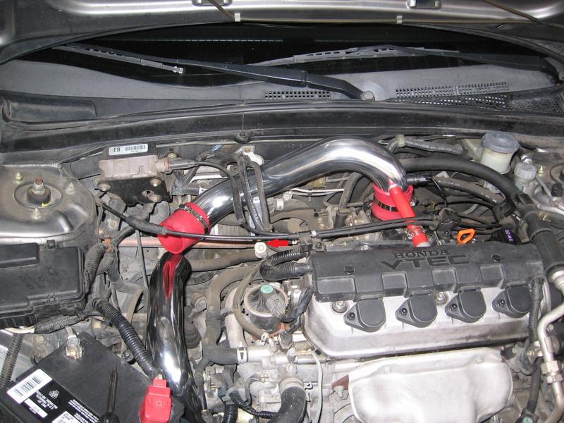

Fugure9 shows how the engine bay looks like after instaliing the cold air intake.
