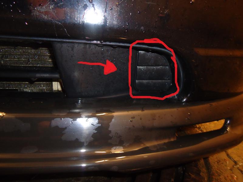

i got a copy of install instructions from honda for their oem fog lights (which should do the trick as the ebay ones are just re-productions) and it never said anything about taking the bumper off. i thought i would have too? or do people leave their bumpers on when putting the fog lights in?
also, when cutting the bumper do u dremel out the whole slatted piece that i have highlighted in the picture that i posted?

Re: 01 civic fog lights??
I took mine off for sure. There's no easy way to cut the bumper with it on since your best vantage point for cutting with a dremel will be from the back. Don't be lazy, just take it off

yea im going to take it off. but does anybody know exactly what it is that i have to cut, do i cut out the whole piece that i have circled?
I had no idea how to cut the bumper so I just cut out the black filler piece and the fog didnt fit in at all so I just winged it and used a dremel to cut grooves and holes where I just thought they would go. In the end it turned out pretty good and they hold in well. I only found instructions after lol
