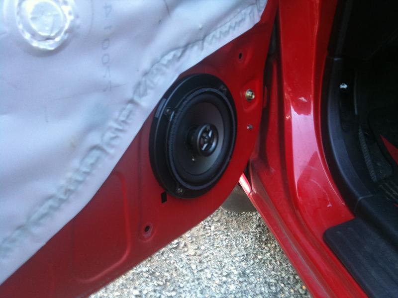

kk so i finaly got down to replacing mine after revising my what i can call budget XD but i want to be sure i buy the right one! Its for my driver side door on an '03 coupe. If anyone can link me one from ebay that would be very nice of them thanks. and anything else that i should know about them, i already know how to replace them.
Oh yeah almost forgot, wtf do i do with that white plastic inside my door panel? XD

i ripped out all those plastics and never had any problem. i think its to keep water from touching the back of the door panel for some reason. and go with the honda part. the whole latch assembly with actuator is no more than $50. i did mine recently and its a really easy job. www.hondaautomotiveparts.com
