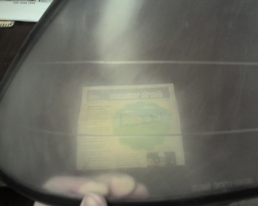

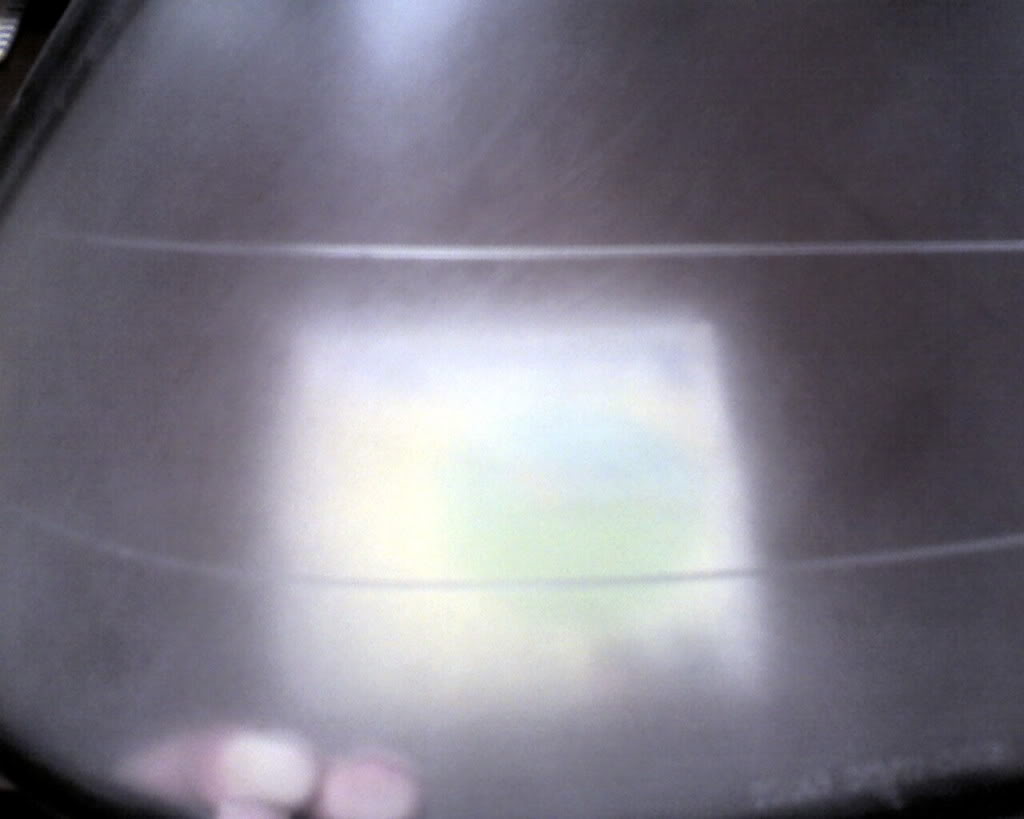

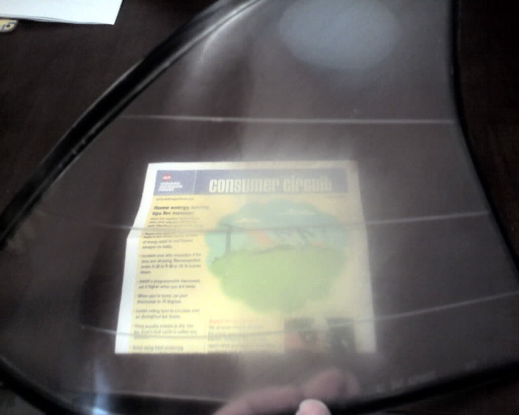

Pretty simply process really; strip you're nightshades wetsanding with the 120grit, and progressively sand your way up to the 2000. I think I spent about 5 mins for each grit (after the 600), but your hand and the paper will tell you when it's done. Unfortunately I missed taking a shot of the messed up lens, but here are progessive pictures after each stage (with the AEP paper for comparison)
*600 Grit*

*1500 Grit*

*2000 Grit*

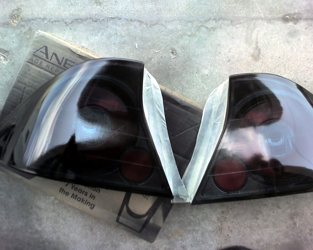

Once you're done with that, time to start workin in the Meguiar's. It's as easy as following the directions and doin work
*Half/Half Comparison, Before and After*
*Finished*
*Closeup (look closely, you'll see the reflection of my phone)
