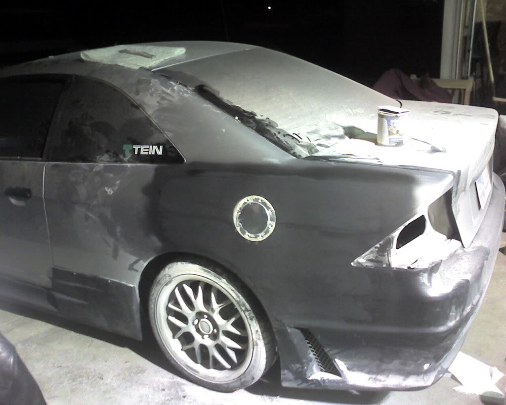

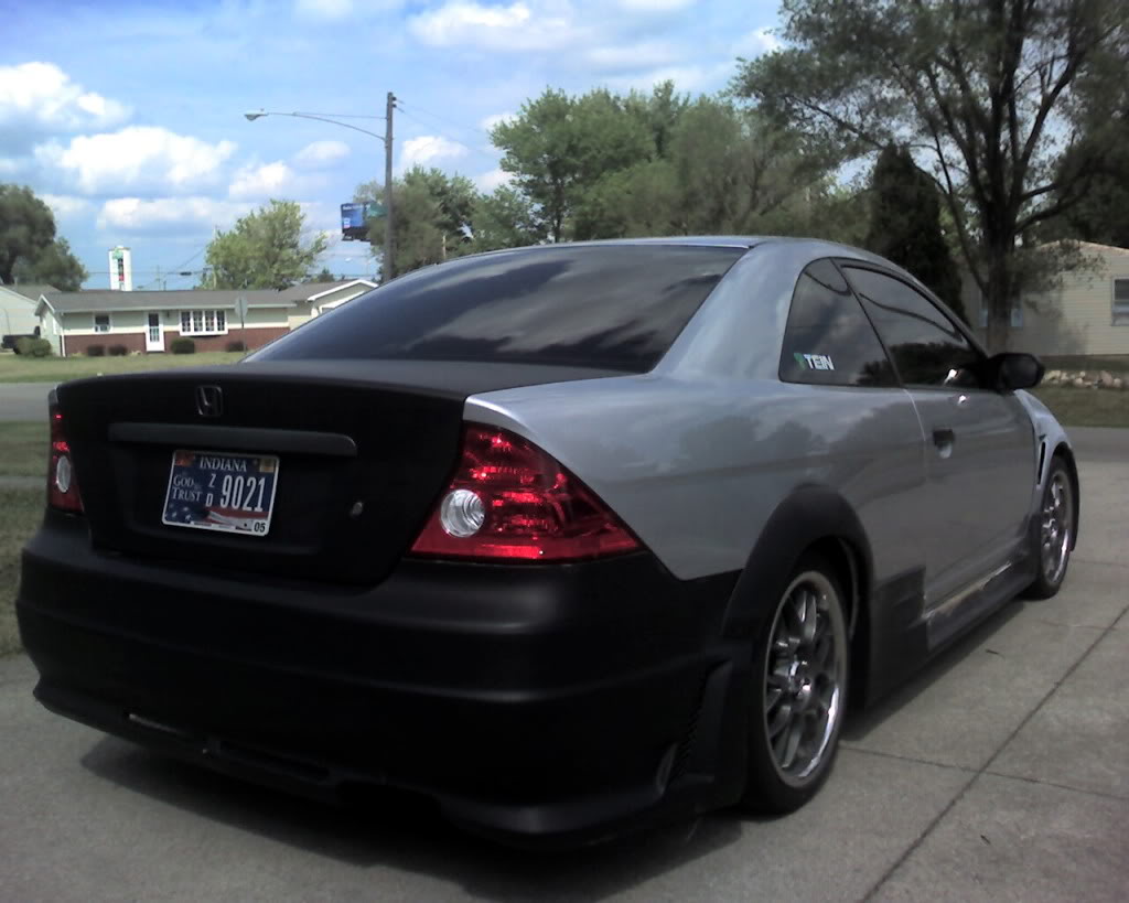

** Project Update! **
Hey everyone, just got some photos arranged and wanted to post up my progress on the fuel door. I originally took this project on as sort of a 'primer' to body work and sorta get my feet wet. Love the look of these gas doors, and I thought it would add some originality and custom 'flare' to my ride, as I've never ran across another 7th gen with this mod. Couple of you guys weren't too excited, maybe these pics will give you somethin a little tastier to check out

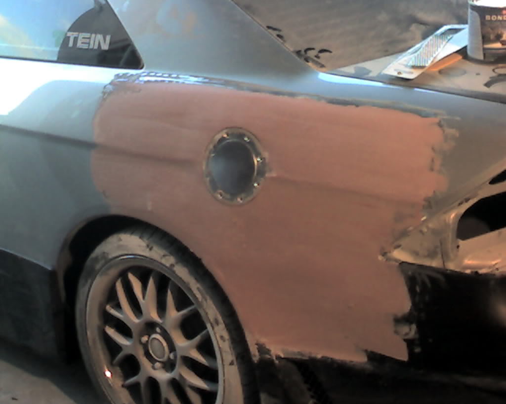

This is after I ground down a pretty large section around the fuel door to feather in my work. Also layed my fiberglass mat to start molding in my rear valence. Notice how much I overlapped each side: trying to isolate the movement/expansion and help these pieces move together. Theoretically this should stop cracking and whatnot, as it's much much better than just slapping bondo. We shall see!

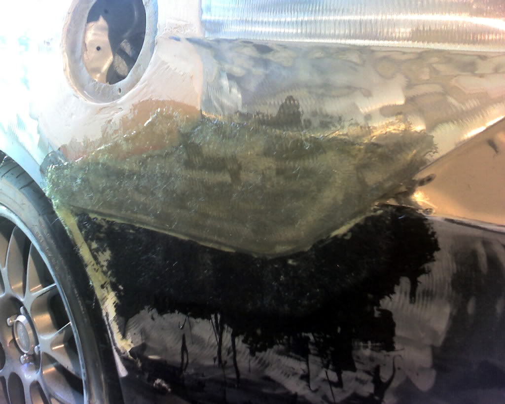

Here I started 'building up' to get my lines right, and help that billet door conform to the side of the car.

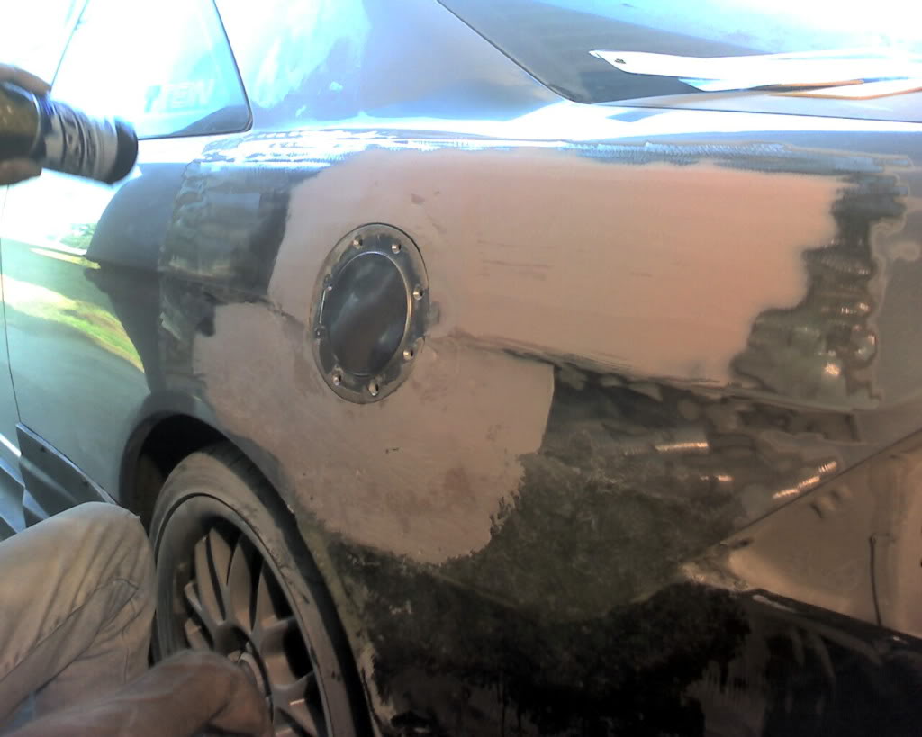

After much work and sanding, I layed down my skim coat to begin the final shaping and feathering. I've still got a lot of work to do, as far as smoothing and finalizing my lines but it was getting late and my arm was quite sore lol.

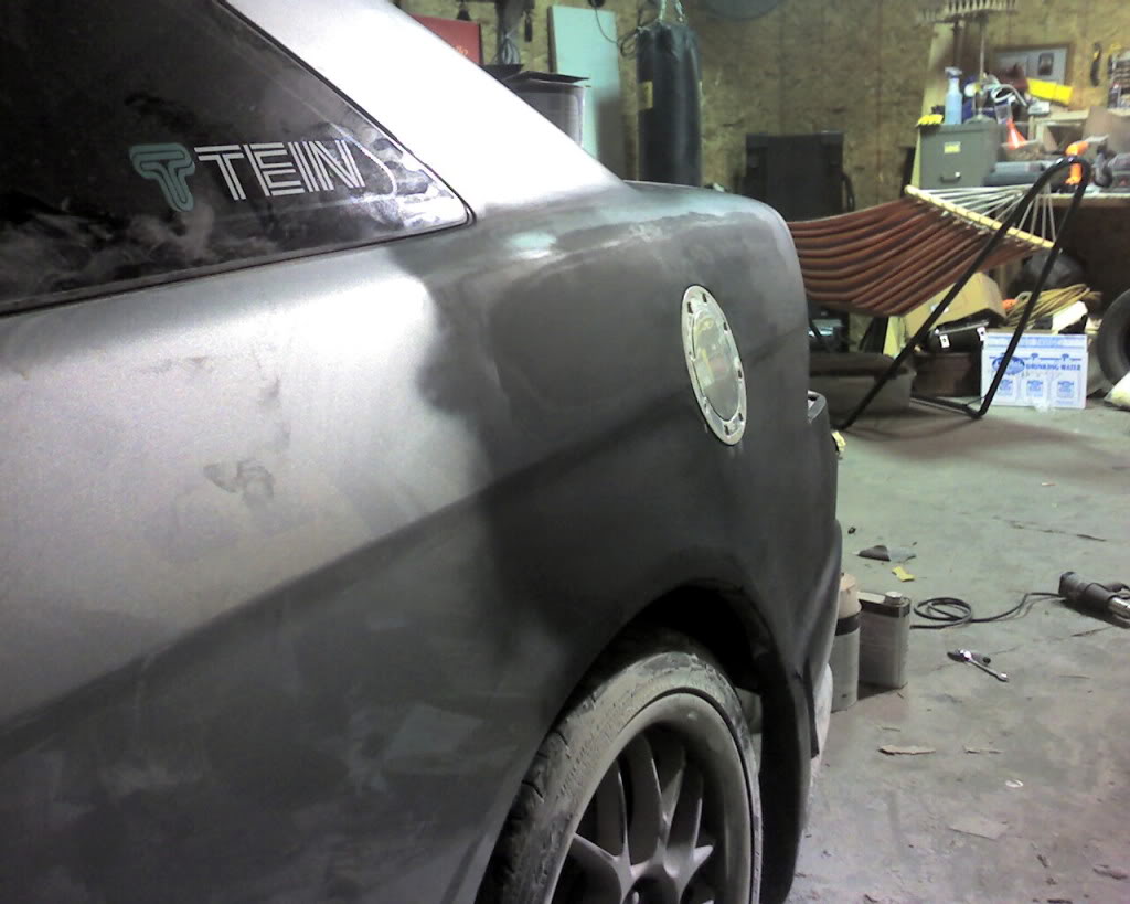

I shot some cheap *** rattle can primer to seal it off for now, once I return to the project this will serve as a nice guide coat for finish sanding. This also gave me a pretty good idea of what my finished product would look like. My opinion:
Here is the last pic for now, it shows the body line and how I'm retaining it throughout the mod. If I jack up the lines of the car it will surely look like ****.. So far I think I've done a decent job - what do you guys think?

now that its all on there i think it actually looks pretty good. way better than i expected it to. even though its not really my thing, i can definitely appreciate when someone takes a lot of care in what theyre doing and do it properly.
one thing im wondering now though...you molded the rear bumper to the side of the car as one piece...did you or are you going to do it to the other side as well? and is it just me, or is it going to be a huge bitch if you ever want to change bumpers or do work underneath?

Heh heh, I do throw quite a few punches but I've never been in that damn hammock
Thanks for the kind words guys, and kudos to unTuned for noticing my attention to detail - definitely makes this stuff worthwhile. Everyone is biased towards their own work, but when other respectable folks take notice it's awesome. Looking forward to Gearbox leaving his thoughts

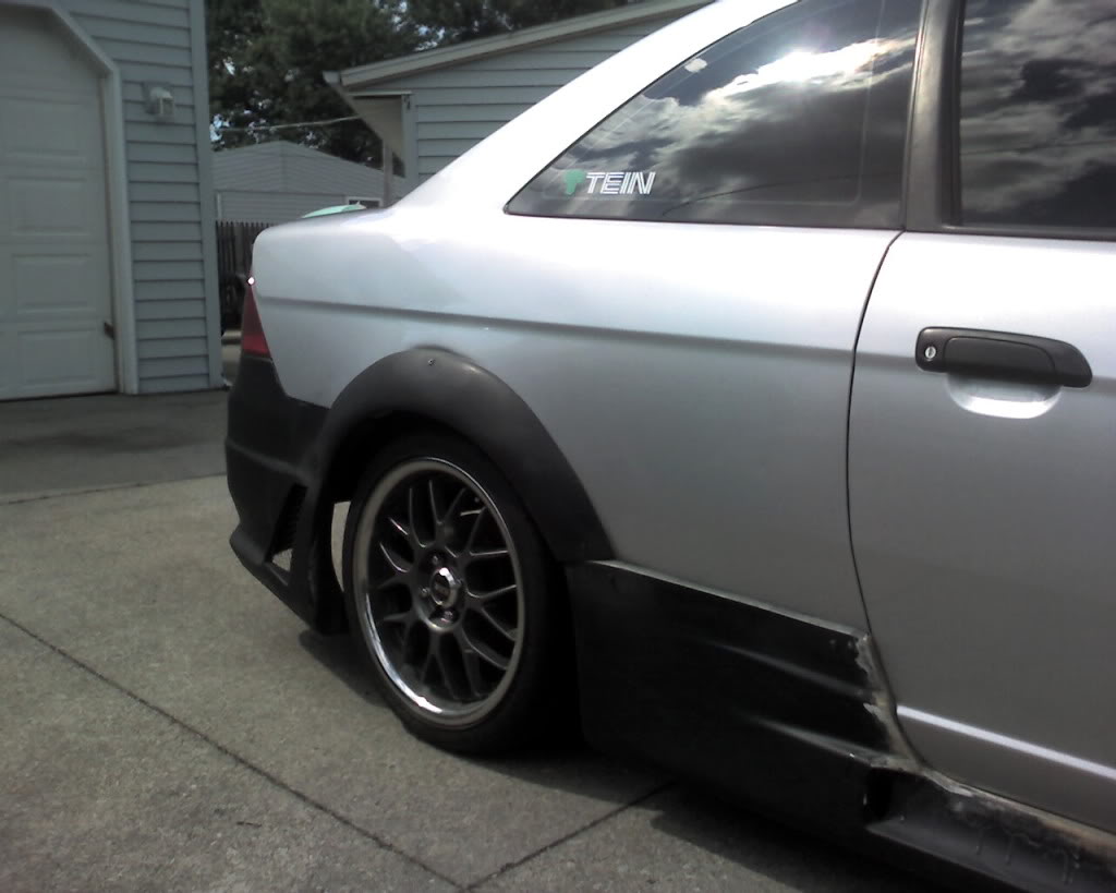

To answer some questions I did completely mold it in, and will be doing the same thing to the other side. The reason being is mainly due to the fender flares I'm going to install for a psudo wide-body appearance. I snapped a shot of one of the flares 'tacked' onto my quarter and a wider shot to see the profile of the car. I bought the style of skirts I have in order to make everything flow correctly. Once I get it all done, it should look pimp. It's definitely on there for good - but I don't anticipate any issues. Any work I would do beneath the car wouldn't require the removal of the rear valence. If it does -
Whatcha think?

i figured any work would be done from under, but its still a very risky job. knock on wood..but if you ever get rear ended its going to be nasty job. especially if a shop has to work with it.
anyway, looks good so far. keep the pics coming of updates, i want to see the turnout. good work. +1 rep for a good project with follow up.
