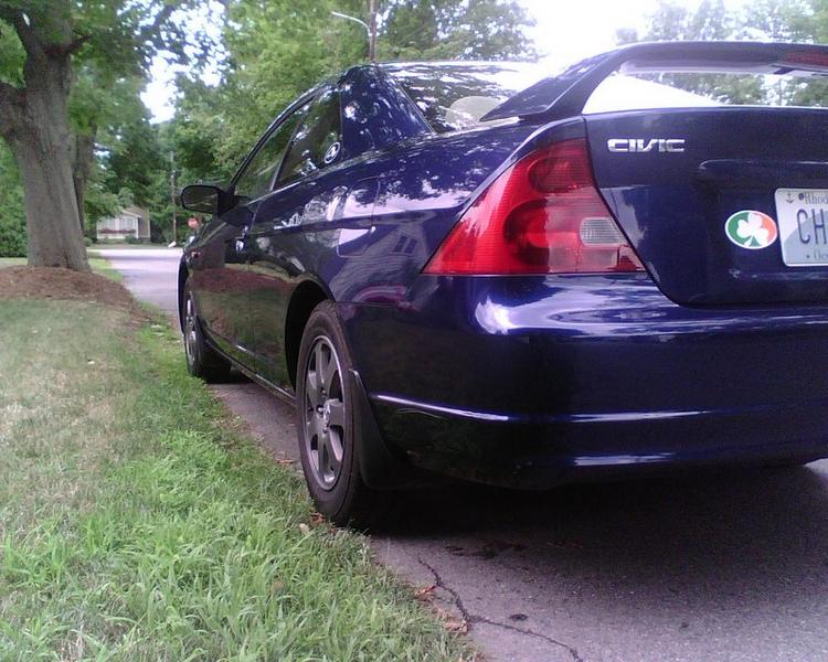

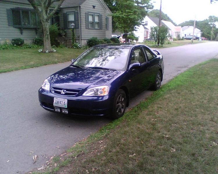

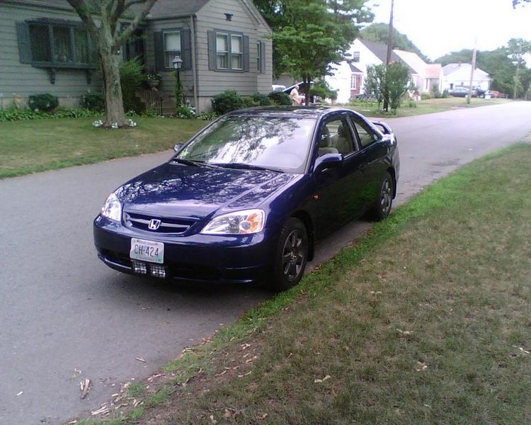

Hey i hope this helps you. i painted my 02 (00SI rims) almost a year ago. all i did was sand down every surface your going to paint. make sure u get it good cause this helps the paint stick to the rim. i did mine in gunmedal.. did about 3 coats and another 2-3 coats of clear coat. it took me a few days but i had my summer rims on my car at the time.
good luck!
this is what they looked like when they were new
and this is how they look after one New england winter and my most recent car wash.

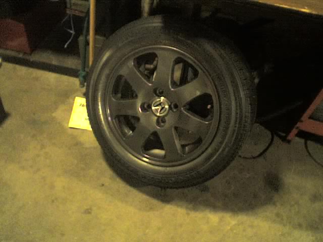

i painted by 05 special edition wheels like a mat black color i'm not a big fan of spray painting wheels but i was bored i was surprised how many good comments i got for them. ill post pics later tonight.
i started off by sanding the wheels down and cleaning with liek 600grit paper and water then threw on the first coat and sanded it again and then a 2nd coat etc..i didn't clear coat it cuz i wanted to keep the flat black look. took about 3-4 hours cuz i was rushin
