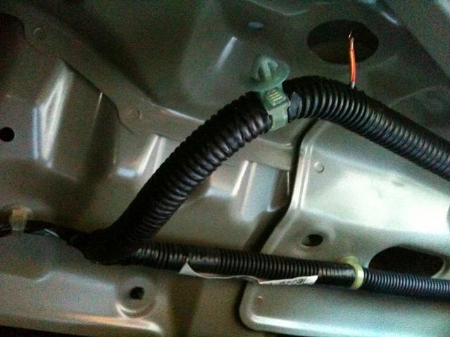

Thanks for the info. After checking the bulbs and fuses and finding them fine, I wasn't sure where to start poking around for the wires and I came across this post. It just happened that the break was right at where the push-mount cable tie was. The electrical tape around the cable conduit was already a bit frayed from the cable tie so it was easy to peel off in that area. New pics are attached below since the old posted pics don't seem to work anymore.
I pulled one of the wires out to show where the break is in relation to the cable tie. The other two pics just show the bundle of wires which need to be recrimped or soldered together. The crimp is covered with electrical tape from the factory. Oh, and this was in a 2005 Civic sedan.
