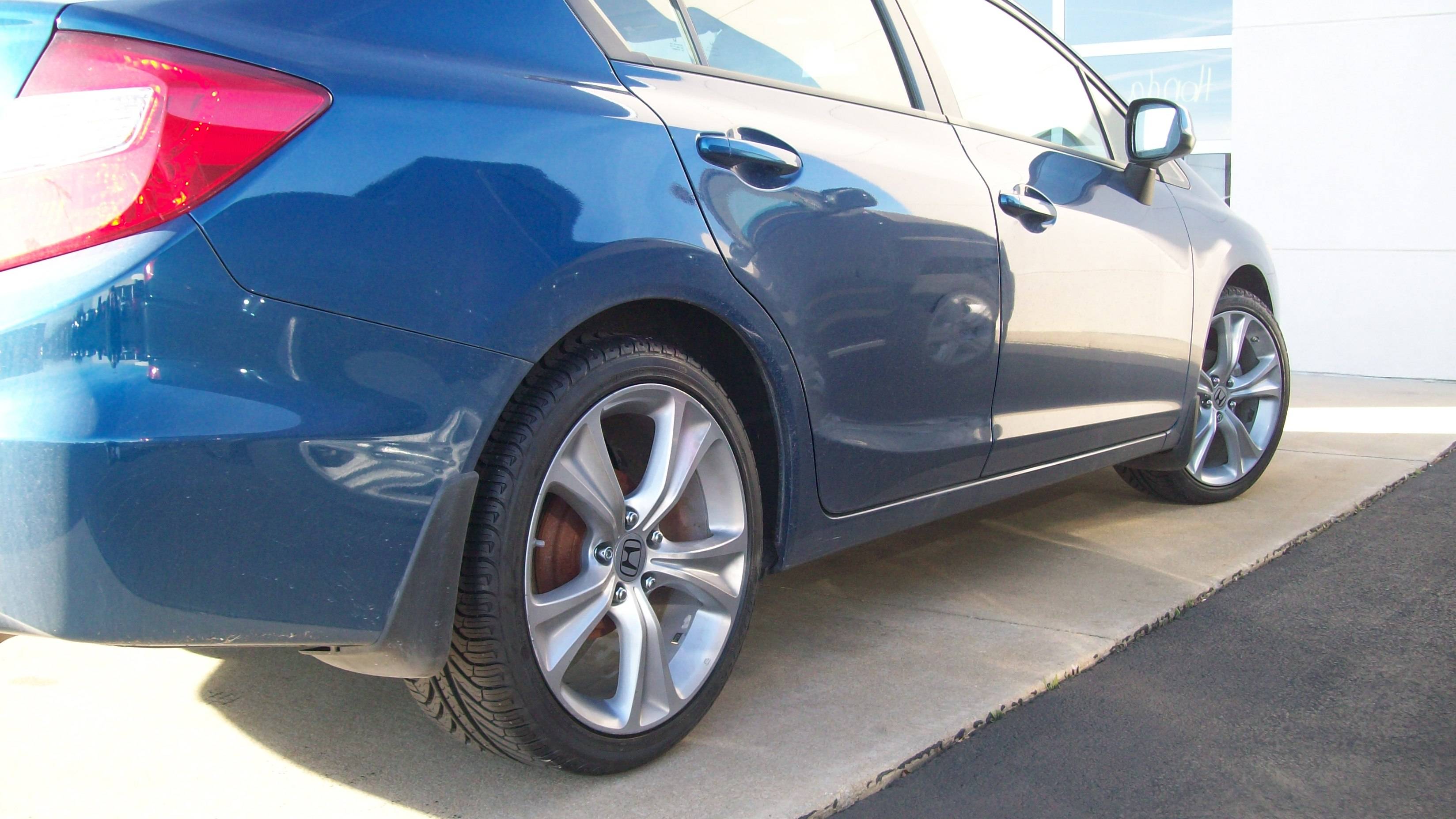

The worst thing about Hondas drum brakes is they just don't look all that cool when you put on big wheels.
My (kinda dirty) 12 LX right after I put 18" Accord wheels on:
