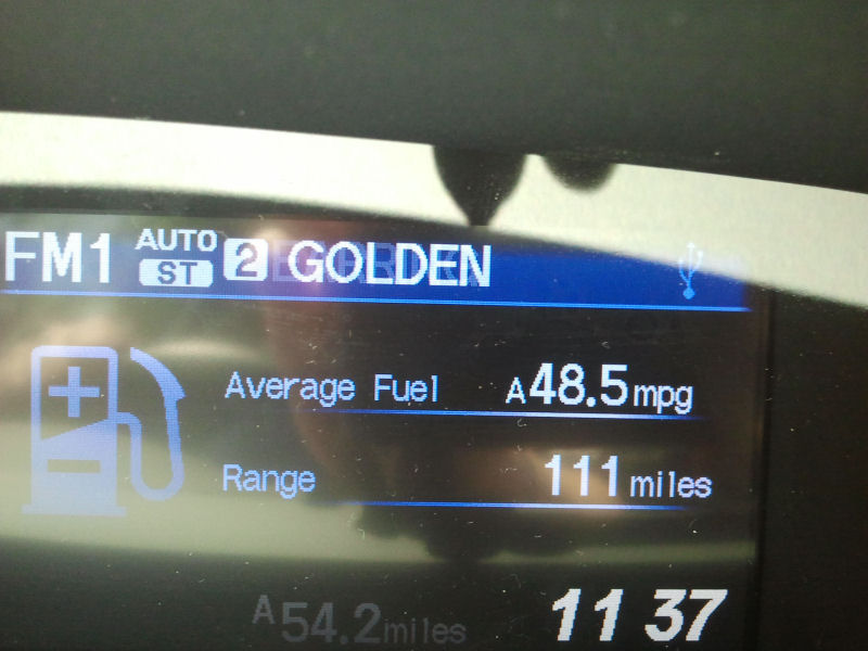

Just bought a 2012 Civic LX and turning on ECON button really made a big difference on the freeway with cruise control set at 70mph, the mileage computer averaged 48.5 mpg on a 130 mile round trip to Los Angeles and back! We now have a 1000 miles on the car with only two tanks of gas and each fill it took 10gal, the tank is 13gal but the car seems to alert it needs gas way sooner. Around town the car is averaging 33-35 mpg with ECON turned on.
