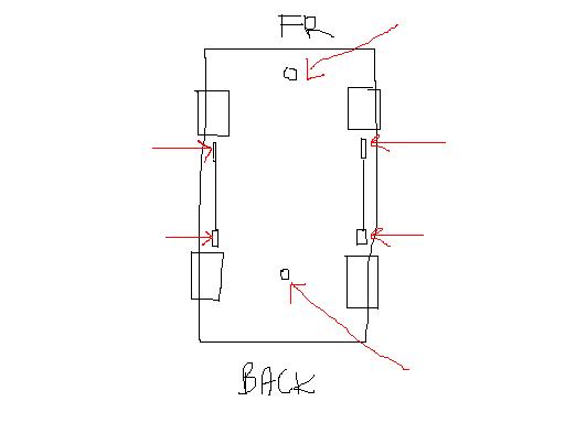

why do you gotta take off that black spoiler thing on the bottom of the bumper? also do you really gotta jack up the car if so where do i jack it up from, ive never jacked up a car in my life so i dont know, i have a jack but there are certain points to jack the car up where are they? and do i jack it up from the side or from the front?

The jack points are:
1) Look under the front bumper basically midway between the right and left side. About 8 inches back, you should see a big arrow on a big 2 inch bar of metal. Jack it up there.
2) On the sides of your car about 4 inches behind the front wheels, and about 3 inches in from the door's edge is a thin strip of metal that's closer to the ground than any other part of the car. It looks like it's been banged on by a hammer for about 4 inches of its length. Jack it up along those 4 inches.
You really don't need to jack the car up to take off your front bumper. All you need to do is take of the two screws in the wheel wells with a philips screwdriver and all the plastic tabs underneath the hood and underneath the front bumper. There should be 4 underneath the hood and 4 underneath the front bumper. You may have to turn your wheel to gain access to the two philips screws in the wheel well.

Added a diagram. Hope it helps.

Eh we all didn't know where the jackpoints on our cars were at some point. Years ago when I looked I don't think our manuals were terribly descriptive about where on the underside of the car to jack the car up. He might have thought those two fat 2x4 looking metal bars were the jacking points.
Now that I look tho it is kinda clear. hehe.
