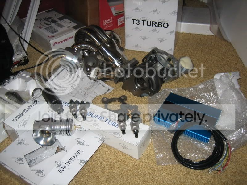

eh, ok i have a weird question. i might be getting an e-manage for an awesome price. well alot of stuff for an awesome price. anyway, it will be an e-manage AND harness. here is the problem, NO SOFTWARE. should i bother getting it? where can i get this software? its needed to use the emanage right? sorry if i don't know. i really have no clue. where can i get this software? do i need a key for it, will a specific code only work with the specific emanage unit? someone let me know. THANX!!!

this is what ill be getting minus the exhaust mani. MAYBE. not sure yet. all that stuff. but anyway, thats the only harness i see. i guess ill need to get the software online and the cable too. it connects to my laptop right?

yea mine has a smaller serial port. anyway, what is that harness shown in the pic? besides that one, and the computer connection one, what other harness do i need and why?

that looks to be the main harness.. you need the ignition harness and the injector harness. if i were you, i would purchase the plug-n-play kit for the emanage blue. it makes your life so much easier.. no hacking up and cutting the wires on your stock harness. plug and go really easy.
you want the injector harness to control your fuel delivery and you want the ignition harness to control your ignition timing (advance,retard all that good stuff.) i highly recommend the greddy pressure sensor. it lets you tune the car off/on boost.. without it the emange does not know when the car is under pressure and whens its not. also makes like much easier.
