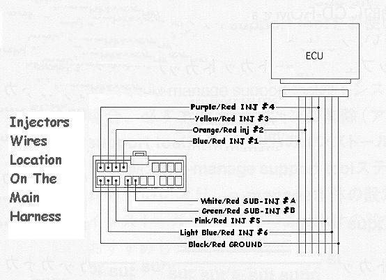

does anyone know how many wires are on their main harness for the emenage. I have 11 (it's from the greddy rsx kit) But on the diy I have a black and red and an oragne left. nayone know? maybe they joined the injector and main harness in the same connector?
DIS DIAGRAM PWNZ J00~
Quit hijacking too........

Old Nov 22, 2004
HyaBoosta's Avatar
Posts: 2,784
From: Miami
Rep Power: 299
sorry for the hijack just thought since everyone who had an emanage was on this thread that it could help. I still have 2 extra wires, but i'll give it a shot.

From: Buffalo, NY, US
Back on topic
It's ok.........I was just playin
Hope that helps
