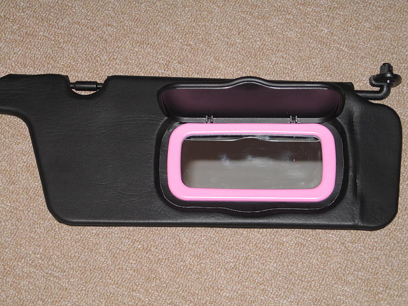

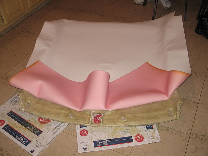

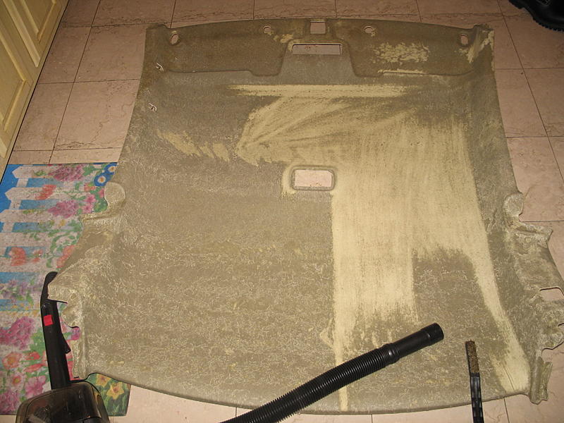

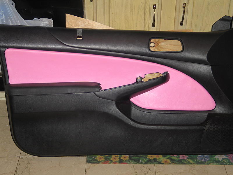

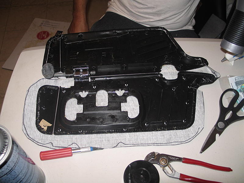

Custom Headliner/door Inserts/visors!!!!!
Hey guys, My wife has been asking me to do her interior and i finally got a chance to do it. Check it out....i have more pics of dissasembly and reassembly if anyone has any questions....Its an 02 coupe by the way.
Everything is pretty straigh forward but requires time and patients!!!!!

sure dont lie we all know thats for you,,, lol
what part is that in the last pic? and what kind of material are you using?

In the last pic is the visor with the trim ring around it. I used vinyl for the doors and headliner

Well the map light is simple, Just use a flat head screwdriver to remove the two clear lenses on the map light. Then you will see i believe 2 10mm bolts. Once you remove those it comes right down!
The oh Sh*@ handle has 2 plastic caps on each end covering the bolts. Remove the caps with same flat head, and then remove the bolts.
As for the visors, well unscrew it from the headliner, then carefully begin to pry it open, go slowlyso you don't break any clips. It is like a clam shell as you can see in my pics above!! Just snap in back to close it up when your done

Hey TRIZ, You have a coupe right? Well the couple inserts are more of a pain than the 4 door, Once the door panel is removed, you have to cut off some plastic welds that hold the armrest in on the door! The actual insert itself does not come off!! You must do it on the door. Precut your material tracing the old insert which is removed by simply pulling it off. Once off, just trace it onto the new material. Use some 3m spray adhesive and begin to cover the insert tuck in the edges with a plastic spreader or something thin and non metal that won't cut your new material.
If your doing the headliner, that a more involved project that requires time and alot more patients than door panels. So try the doors first and see if you think you can do a bigger and more involved project. GOOD LUCK, JUST REMEMBER IN THE END ITS ALL WORTH IT
