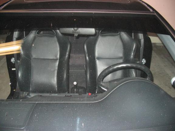

here are the pix anyways...

very nice, i envy you.
Nice! Now clean your windsheild!

those look awesome. i want some. you ever think about gettin the rears??

got the rears too, just need to see how to modify it. I took out my rear seats like once and it was only the bottom peice.
