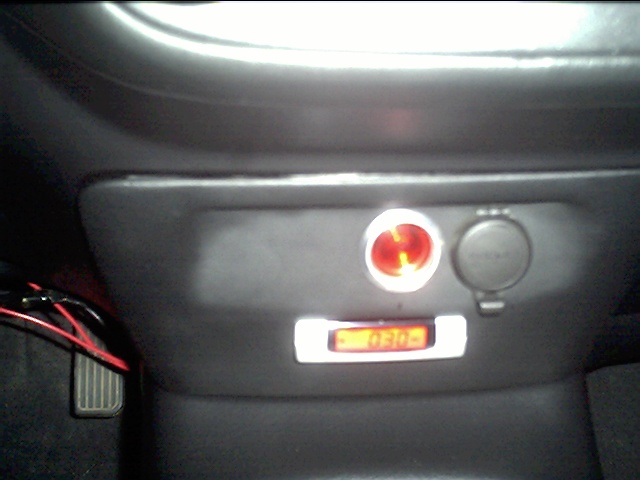

here is mine with my turbo timer...custom install...the 02's have a pocket on the bottom of that piece...turbo time is in there....i still have to use the key to turn on ignition, then i can push the botton to start....
