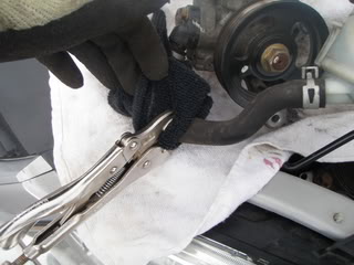

First, remove the mounting hardware from the pump. Swing it into a good position and place a rag or towel under everything (its may DRIP all over your alternator, LCA and belts). Crimp the lines with rags and vise grips and remove the bolts holding the lines on. Remove the pump:

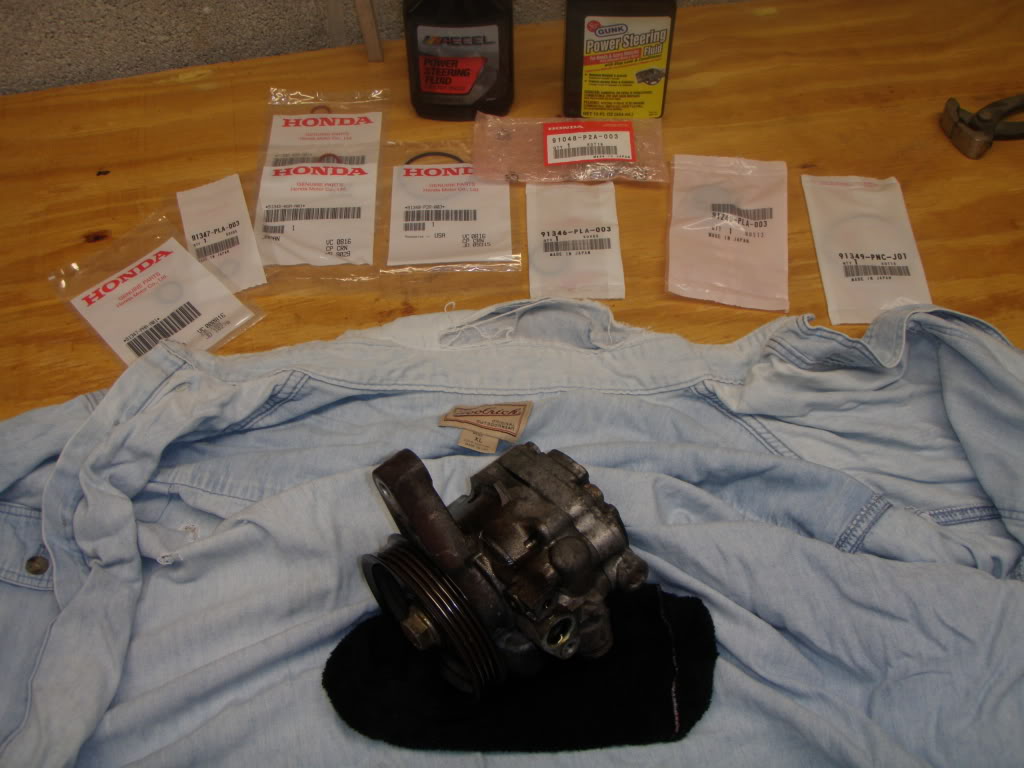

Clean your bench good and line up all your supplies. Get ready for the fun parts!

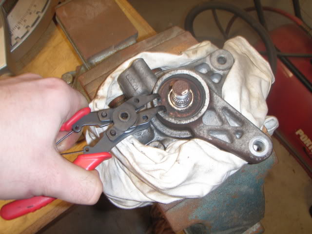

Now beak out your cir-clip spreaders and remove the cilp holding that damned, squeaky bearing:

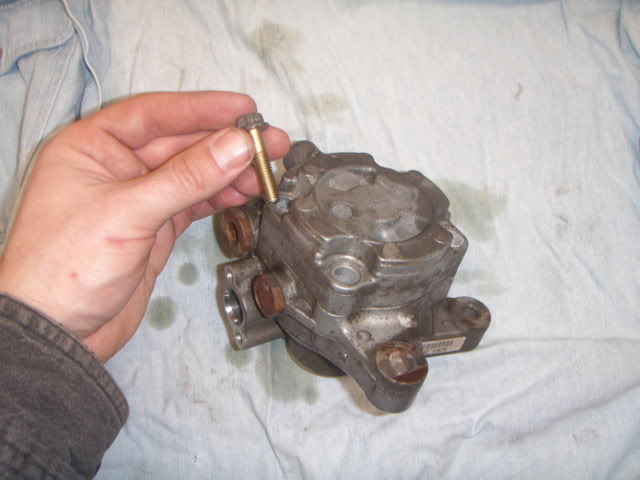

Now go ahead an remove the 4 bolts holding the pump together:

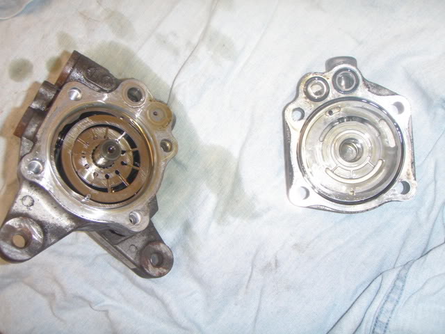

Remove the cover and set aside:

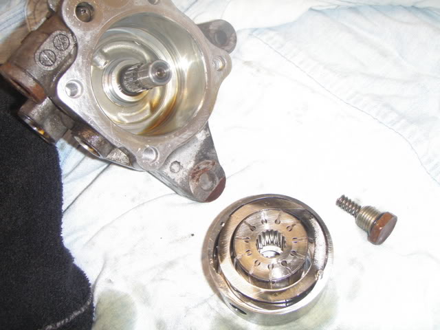

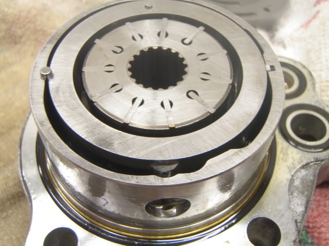

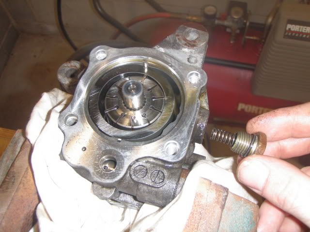

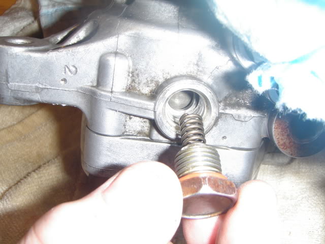

Remove the spring pressure thing. Observe the location of the though holes in relation to the spring (VERY IMPORTANT!):
Seperate the internals. carefully note locations and placement/direction. try to keep as one unit as best you can. set aside:

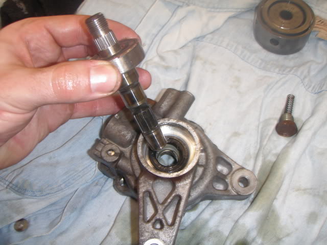

Press out the shaft/old bearing asmy from the housing as one unit. Use whatever means you have involving a mallet or large hammer; use wood to cushion the blows to the shaft:

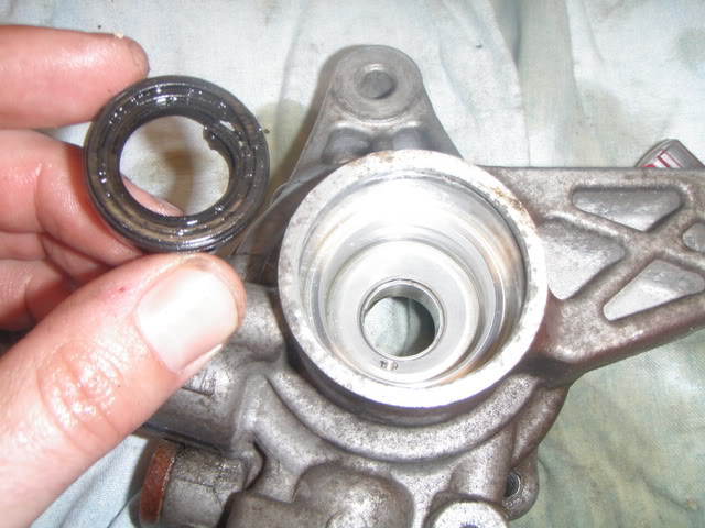

Remove the black shaft seal. Replace with a new one using your fingers or large socket if needed. set aside:

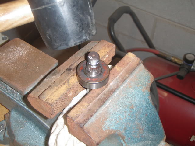

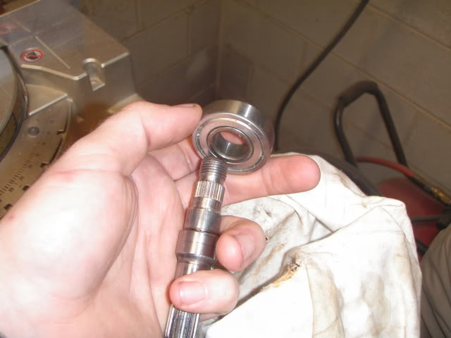

Grab that shaft/old bearing asmy. Force the shaft out of the press fit bearing. Use a vise to let the shaft dangle freely as you whack away with a large hammer and a 2x4 to cushion the blows. (tried to do it with a rubber mallet=no luck):
Dont be scared, it'll whack loose:

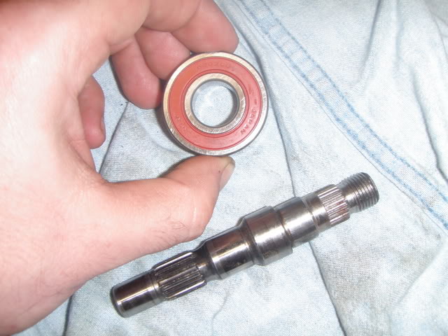

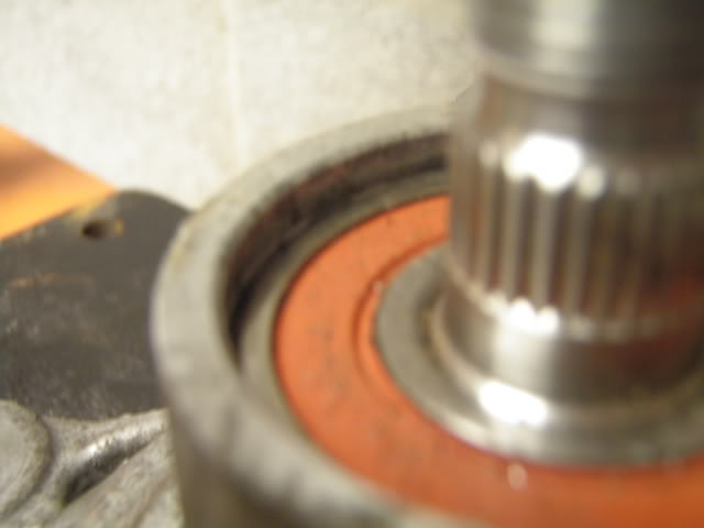

Install your new bearing. Orange side should be facing threads:

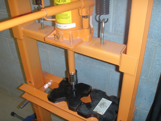

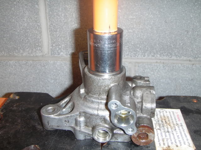

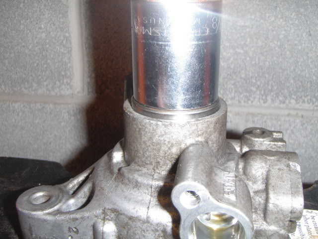

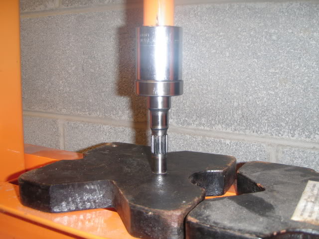

Press bearing onto shaft. I think I used a 1-1/16" socket. Fortunetly for me I had access to a 12 ton press!
Make SURE its goin on strait!!

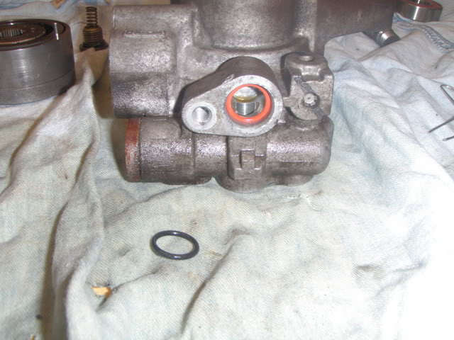

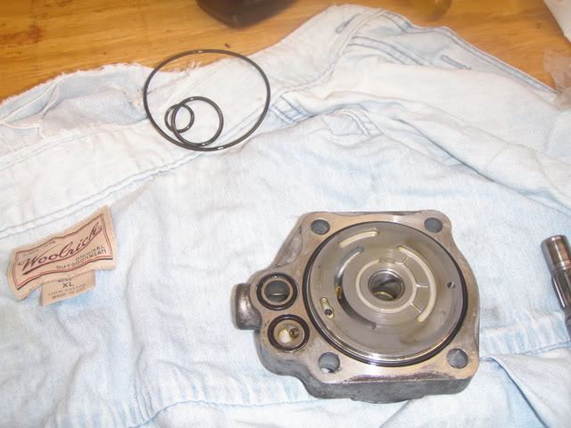

Replace all your gaskets, if you have any:

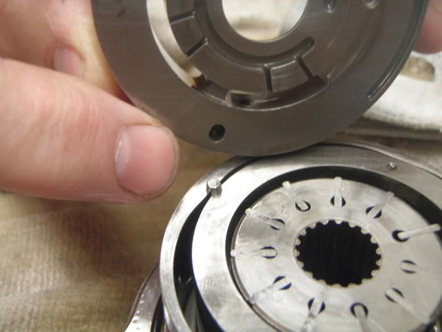

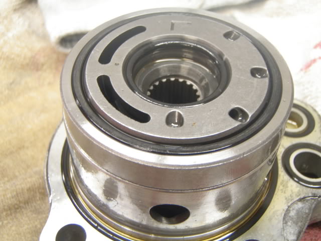

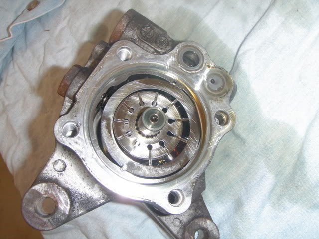

Now restack your components together. PAY ATTENTION!! It is keyed, but CAN be wrong. Observe pics CLOSELY for alignment reference. It should look EXACTLY the same:
Line up pin with SLOT, as pointed too:

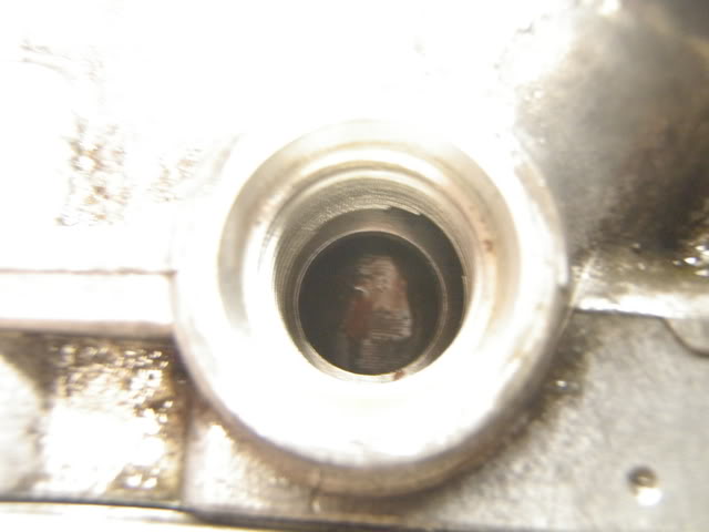

Re-assemble housing/shaft/bearing asmy into your careful stack. Its a balancing act, so have patience and be kewl...
Look closely at that hole in the side...it should look EXACTLY like this through the housing when mounted:

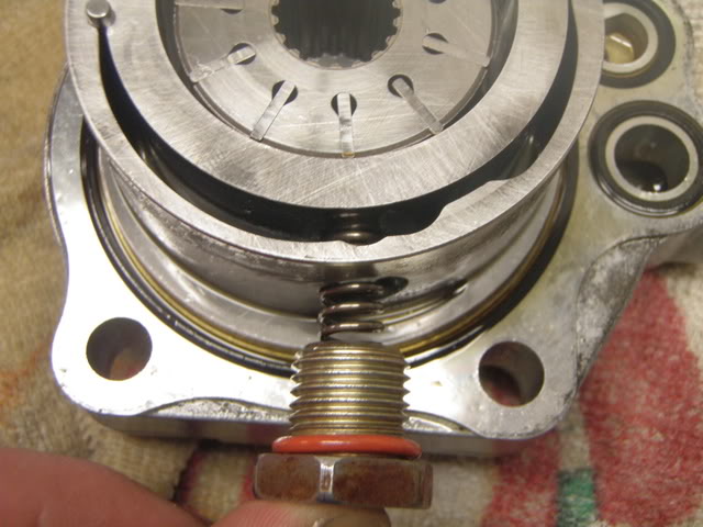

Now re-install your spring thing. it should ingage the inner circle of the pump, pushing against the vanes moving it to one side, with vanes still concentric to thru hole. the top peice and housing has been removed for clarity in the first pic:

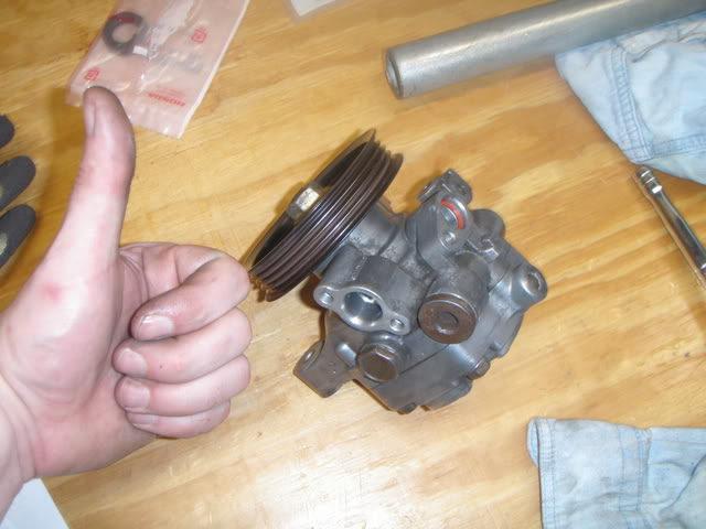

Re-install 4 housing bolts.
Re-attach the pulley using the same means as you removed it.
Vise it up again, plug inlet/outlet holes and bust out a wire brush so it dosent look like total ****.
And BAM! Freaking saved yourself like...over a hundred bucks!!
