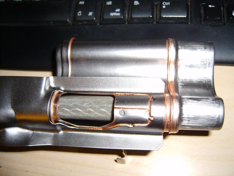

Well sorry to say but TCI doesnt make the 01-05 overhaul kit anymore... Just replace the 3rd clutch and buy a new OEM filter from honda (they have a revised one that is bigger then even the one I used)
Check this out compared to the one on the first page.
