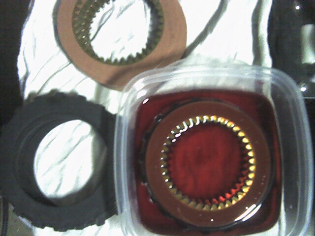

I got the TCI kit and am about 30% done building the tranny. Here is a quick pic I took of the clutches and plates soaking in ATF.

Ok guys the build is all done. I diddnt mess with the valve body because I dont feel there is anything wrong with it at only ~60k miles. I just replaced the clutches and the O-rings on the main and countershafts checked all the tolerances and put it back together. I am planning on installing it over labor day weekend so I have the extra day incase there are any problems. I will let everyone know how things turn out.
