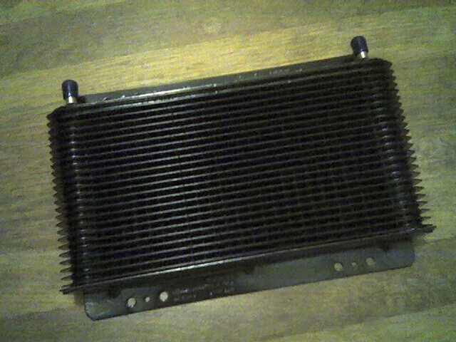

This stuff will be installed saturday. I dont think I like the zip tie method of mounting the cooler so Im gonna be looking for another way to mount it.

The one I got is actually 1.5" thick but I’m going to be putting it in front of the AC condenser so I’m not concerned.
Pretty much the same way Boiler put his engine oil cooler.

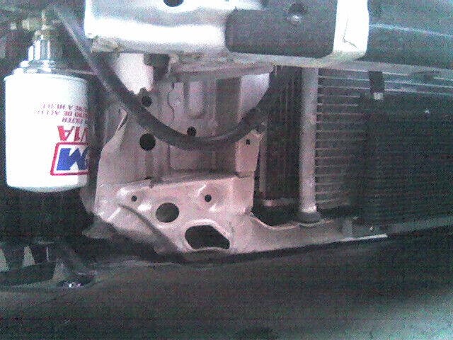

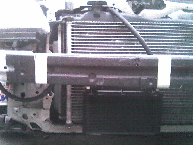

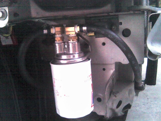

The filter and cooler are installed after about 3 Hrs of work and 2 trips to Autozone. Even though it looks like the hose is rubbing going from the filter to the cooler, it has about 1" of clearance all around it. I also had to buy a bunch of fittings just to get a 90 degree 3/8" hose barb going from the filter adapter. Its not as nice looking as Earls fittings but they work with no leaks.

Between the filter and coler the car holds about 1.5qt more ATF so it will stay clean longer. Like 5000 miles after I put the new tranny in im gonna replace the filter and cut this one apart so I can see how much crap is inside.

well they say in the instructions to have it before the cooler so i put it like this.
Trans - Radiator - Filter - ATF cooler - Trans
I will let everyone know if this helps the slipping on her current trans. the only way it would help slipping is if the pressure in the trans was dropping from a clogged ATF screen (which it could be). If your clutches are already worn then its beyond help
