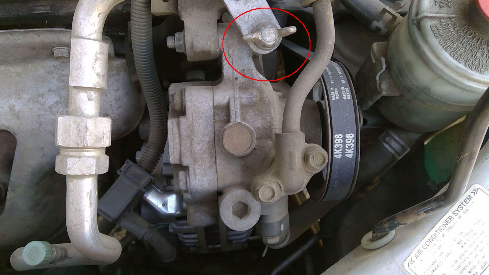

3. Use your 12mm wrench to LOOSEN the bolt circled in the photo.
3. Use your 10mm to remove the wing nut/10mm bolt (it will vary depending on model year)
3. Loosen the BOTTOM 12mm bolt on the PS pump. (Sorry, I don't have a photo for this one.)
4. After loosening the bottom bolt, The PS pump should be able to move back and forth freely. This will allow you to remove the belt. Either keep it or chuck it. I saved mine incase I ever wanted to reinstall the system.

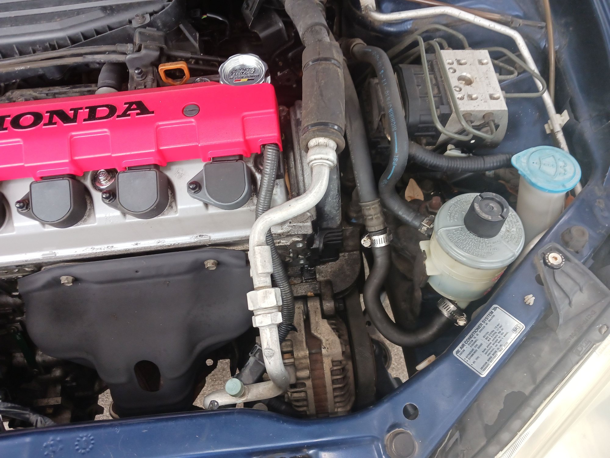

9. Now is the part where we get our pipe cutter. You need to take your time with this one, so that the cut is clean and not burred. Using the pipe cutter, cut as evenly as possible around the section of high pressure line circled in the image. We are aiming to leave as much "straight" barb as possible. That means make your cut as close to the "bend" as possible.
10. Now, we take our small, roughly "U-shaped" power steering hose that runs from the reservoir to the pump and flip it REVERSE IT. Using two hose clamps, secure the ends of the hose to the reservoir, then onto the "nipple" you created. There is just enough length to make this connection. I would *DEFINITELY* take the time to inspect the hose and make sure it's in a condition to be reused. If not, you should replace it with a Honda part #53731-S5D-A01. I believe a piece of 9/16 ID hose of the proper type can be used from the auto parts store as long it is the right type of hose.
11. Last but definitely not least, refill your power steering reservoir to the correct level, then get in the car and turn the steering wheel back and forth several times making sure to fully cycle the steering rack to it's steering limit. As the fluid fills the rack, top off your reservoir with power steering fluid again to the correct level. Of course, this is also a great time to flush the crap out of your steering rack and use a correct Honda power steering fluid. If you bought a used car, you have about a 50/50 likelihood that somebody paid attention to the manual and actually used Honda PSF. Keep that in mind about your coolant, as well.
12. Reconnect your battery, start your car, and prepare to become a strapping young man like myself .
Your finished product should look something like this. I opted to remove the PS mounting bracket from the block for clearance reasons. That part is pretty self explanatory if you would like to do the same. Also, don't joke on my PS reservoir cap, I had to make a temporary compromise....lol
