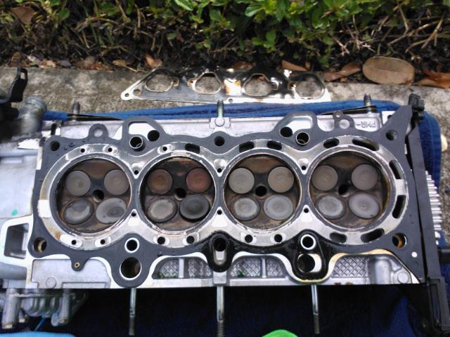

Just for reference and I am in the process of changing the HG. Didn't even bother looking at thermostat, radiator cap or water pump. They were replaced about a year ago as preventative maintenance by me along with timing belt and associated items.
2002 civic ex with 85K
-No overheating
-Coolant spewed from reserve tank on trans and trans side of engine
-Reserve tank filled to the top and having bubbles coming up every few seconds immediately after shut down
-Waited 10 minutes and opened radiator cap. Air blew out and no coolant.
-No overheating

UPDATE: MY HEAD GASKET BLEW OUT, BUMMER
****Replaced Thermostat and Rad Cap, didnt solve problem lead to...Head Gasket BLOWN****
History:
Early Sept - overheated - Resevoir filled to cap, radiator not full. (added fluid, burped system)
**ok for two weeks**
Mid Sept - overheated - Purge system, flushed coolant system, put new fluid in.
**ok for three weeks**
Early Oct - overheated - added coolant, burped system
Mid Oct - overheated - Pulled over, called a Tow Truck.
Took it to the dealer and replaced the thermostat & rad cap and it still overheated. Compression test showed loss of pressure in cylinder #2 after about 15 mins at idle, then resevoir started overflowing.
ISSUE: Head Gasket Leak
Costs,
Head Gasket Set, OEM - 234.82
Head Bolts - 10 - $110
Water Pump - $81.80
Collant - $20
Oil & Filter - $24.20
(Parts total w/ tax ==> $503.77)
Labor $680
Thermostat + Diag Test $210
Resurface head $100
"Shop Fees" $50 --GRRRR
GRAND TOTAL of $1543.77

Looking back, I've gathered symtoms that leads me to believe I should have replaced the gasket long before it got to this point.
Disclaimer: The below evidence is based on stringent maintenance up to this point on the vehicle.
Symptoms:
-Longer than normal starts sometimes because pressure wasn't building properly in the failed cylinder.
-Subtle loss of coolant every month or so. I chalked it up to evaporation, but now realize it was being burnt in the combustion process.
-Poor gas mileage.
These are lessons learned for me and any who read this I hope. I will keep this car for a very long time because of the ease of maintenance on it, including this head gasket repair.
