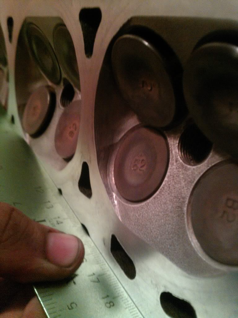

i did not have the head shaved when i removed it. Going back and thinking about a few things, i used a cheap torque wrench... could have possibly not torqued enough?
regardless, this is what my head looked like when i took it out and tested the it against a straight edge.
oh yeah and Monday i will be getting some ARP studs, compression test and the leak down test will depend on how the compression test goes. Problem is i dont know who is reputable around orlando. and i would just feel uncomfortable going somewhere not proficient in honda/acura.

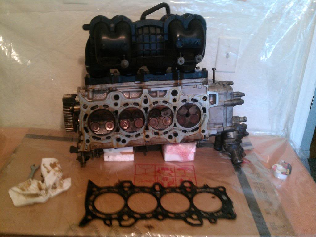

I scraped off what I could then used a sharpie to color the mating surface. Then a chunk of tool steel and started with 400 grit and worked my way up to 2000 grit paper.
That was 4K miles ago, I did not have either machined.
I do have a question about the picture with your straight edge. Was the cam in the head?

Update:
hey guys this post might sound confusing, but i looked back over some things and did better investigation work. I think i got some concrete evidence that i had overlooked when all this started. Things get a lot easier the second time around.
My course of action right now is
USED ARP headstuds
Resurface head, hot tank (without disassembling)
NEW OEM gasket (no copper spray)
NEW OEM gasket/seals for valve cover
REUSE 2 week old oil (castrol synth)
coolant flush (properly)
this is no news to any forum member that sees overheating problems/threads all summer. it gets old to recommend the same stuff over and over.
MY THOUGHTS and CONCLUSIONS
(at the moment)
i feel that taking pictures is CRITICAL at times like these when things don't go according to plan. As they say on campus, if there are no pics then it didnt happen.
Since this is the second time i get Gasket+leak=overheat, i was getting scared that it might not be the gasket after all and i may have a bigger problem to deal with. if the gasket did BLOW and leak, there would be signs of it on the HG and the head.... sure enough i found some incriminating pics. (NOTE: THESE PICS ARE FROM THE 1st HG change)
this is it after it was stored for a day wrapped in plastic and finally brought out for its cleaning. Right off the bat we can see that cylinders 4,3,2 have nasty black in between them.
bad lighting but the carbon buildup is reflecting blue. important here is the head gasket. The thin plastic layer to the left is all crinkly and you can visibly see the steel layer. on the right where i do not think there was a leak, the walls between the circles(cylinders) are in tact.
Close up on the bad side. notice how the carbon buildup doesnt really go anywhere past the two closest coolant passages?
above are cylinders 4,3 (and 2 has a spark plug in it)
above you see some of 3, 2 with a spark plug in it, and cylinder 1.. at this point i had already begun to clean with b12 chemtool and paper towels
above is nothing new.
the pics below are after i used b12 chemtool with papertowels. you can see the carbon buildup is pretty stained into the head where it leaked and not very much between cylinder 1 and 2. (where it didn't leak)
I have no clue what that weird scratching around the hole at the bottom is. it wasnt done by me ill tell u that. weird is that they are not deep, just reflect light differently.
NOTE: that was not the final cleaning, just the first pass.
So this takes a lot off my mind, and i can finally say:
  • im SURE the initial prob was HG
  • second HG is a result of me not milling the head and the problem returning.
Im running on the assumption that
  • the leaking between cylinder 3 and 4 is what caused my multiple cylinder misfires and CEL
  • a compression test would have proven the leak, and doing one now WILL still prove the leak, but im not going to go do one.
  • A combustion gas leak test would also confirm the HG issue
  • not sure what a leakdown test would prove. at this point, i can obviously see where im currently leaking oil from. And also it coincides with the same area the gasket is damaged in.
  • I can also conclude that my problems with hesitations (-->missfires) from the past; which i attributed to faulty coil packs, was actually a symptom of my 1st leaky head gasket (loss of compression).
I will start a "Build thread" or somewhere and go through everything since my first misfire a couple days after i bought the car. i will include plenty of pics of everything i found important.
For now, thanks on all the suggestions. if anyone has any more input on my situation, keep bringing things up. but for now im going to be waiting on removing my head so i can get it resurfaced. i will fill everyone back in in a few days
Rich
wow pretty useful bit of info. there is no way in hell that i will remove my block for it to get resurfaced. but this looks like an interesting method. especially by using the sharpie to guide you. (more importantly the large perfect metal 2x4 haha)
and yeah the head was still at TDC. my new post has more pictures in it. thanks for the input however. now i know how i can help my block out.
This is the part no.9018K127 at McMaster-Carr for a precision ground 1 1/2x1/4x1 1/2ft flat stock @ $35.74. I find it indispensable for many a task.
