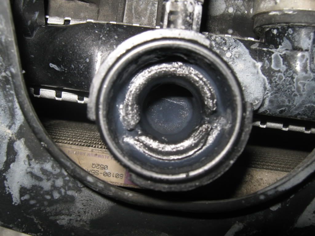

If the neck of the radiator was burned bad enough from steam erosion, so bad the cap can't seal on the pressure side, that would condemn the radiator.
This normally only happens during a severe overheat. The plastic erodes from the steam blast. The lower sealing seat gets burned away first so the cap can't contain pressure even if you get a new one.
This damage is really obvious in the 2nd pic below. There should be a smooth even surface for the lower cap gasket to seal against.
(By the way, an overheat that eats up the radiator like the above also makes the head gasket problem that much worse, or caused it if it wasn't already bad before.)
A radiator fault should be easy to PROVE.

Ok so just talked to my mechanic again. They said they checked the HG w/a compression test and it checked out fine. They said the seal around the radiator cap is starting to erode away. I'm gonna go get it and do this job myself. YAY!
If I'm still losing coolant afterwards (which I probably will be) then I'll find a new mechanic to diagnose the real issue.

Re: Losing coolant, HG?
Compression test will not show you this problem.
