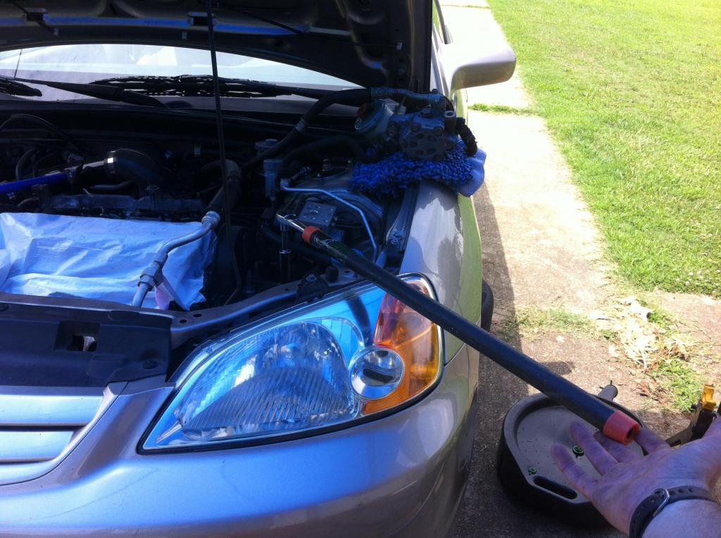

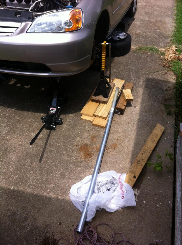

Engine on the bench... you would think it would help with that crank belt... however the lack of ummm car to hold the motor in place can be a serious pain.
Heat + breaker bar + 170lbs sitting on the 2 foot extension + 40 minutes of sweat = me dancing around the barn looking like a fool because the dang bolt finally came out.
Probably could have used a longer extension, but it was just me, so I had to hold onto the valve cover to keep the motor upright as well as apply pressure. Fun!...

i used a 6 FOOT breaker bar, and even with that it was hard!
Handle from a floor jack....
Fence post from the neighbors yard.
You can BUY the crank pulley holder for like 25 McDoubles. http://www.ebay.com/bhp/honda-crank-...p2045573.m2388
Use this with a couple breaker bars and a cheater pipe.
It was as comical as you are probably thinking... Put torque on bar, watch engine dance like a stripper. curse, stop, ponder actions, more heat, more rattle gun, more leverage on breaker bar.
Oh well. its out now. Water pump is replaced. Oil pump will get replaced on Sunday. New tensioner, New Timing belt. Valve adjustment. Maybe if I'm lucky I'll start pulling the "Holy" motor out of the 02 civic that is currently a glorified rolling chassie.
yeah, maybe i should have been more specific, technically it wasnt a 6 foot breaker bar, it was a 24 inch breaker bar with a 2 inch cast iron 6 foot pipe slid over it

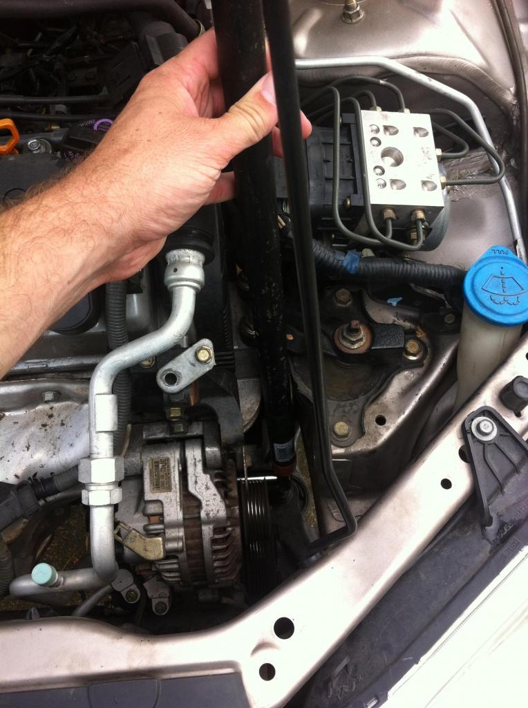

great write up, i actually kept referring between the different ones in the DIY section so I could have pics for everything.
I would recommend getting a 2ft piece of cast iron pipe from a hardware store to help with breaking some of the bolts loose. To get to the lower alternator bolt I tried using one of those elbow joints with a 20" extension and going through the wheel well but was unsuccessful. Finally had the idea to get a cast iron pipe and slip it over the handle on my 3/8" driver. I used a deep socket so the wrench stood straight up and then slid the pipe on and easily popped it loose from the top. You have to hold the hood with one hand so you can put the little hood stick down to make room to work but it's pretty easy.
Same thing works great with the engine bolts. Seems like there's a lot of places where you can only get a fingers on the ratchet or you can't get good leverage. So the pipe really helps.
Also I used a fence post as a cheater bar for breaking the crankshaft nut loose. Definitely thought the pipe was going to crack and then TINK! the bolt broke loose. It's not really that hard with the right tools and a good amount of leverage. The car was up so high I had to use the jack to hold the specialty tool and put some wood under my jack stand to stay perpendicular to the bolt.
But now I snapped a bolt off trying to tighten the water pump so waiting til tomorrow to try and grab it with a vice grip and get it loose. Should of just tightened it by hand but wanted to use a torque wrench to make sure it was right. I think my torque wrench is broken
i have said it a thousand times.....i will never understand why people use torque wrenches on bolts this small, just go by feel, all they need is tight by hand and then a little snug with a wrench,
on a side note.....i bought that exact same cast iron pipe you have except i got the 6 footer.....i agree its very handy, but i wouldnt recommend using a pipe extension like that with a ratchet, only with a breaker bar
