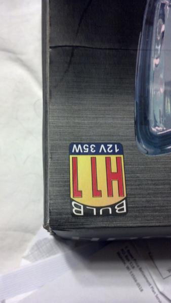

I have a 2005 em2, and my one foglight burned out, the local auto stores could not give me what I think is the right bulb. My box says h11 35 watt, at the stores I only found h11 55 watt, and I could not find the 35 watt on ebay either, any suggestions? thankss!

So your saying get the 55 watt bulbs?

I've read using to high a wattage can cause fires due to the higher draw. I don't want to question your knowledge here because you have proven yourself right so often in my experience but I have to know my own self

It's a possibility (however remote), especially if you have an el-cheapo discount quality setup (as evidenced by the use of apparently one-of-a-kind bulbs LOL).
But even a 35w Halogen makes a lot of heat so I'd expect it wouldn't make a lot of difference upping to a 55w. (roughly 3 amp to 4.5 amp)
If you can't buy 35w bulbs, not even with money, what else are you gonna do? Try something.
Did you ever actually remove one of the original bulbs and check out the numbers and markings on it? Carry that one into the parts store and match it up?
Convert to H11 LED instead? Low heat!
