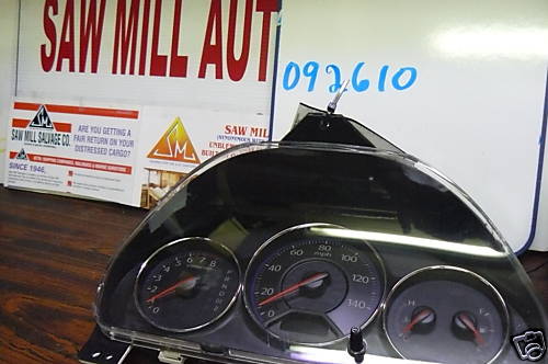

Hello< I have atteched here picture which I got from the internet. This is the same as mine. Please check if I can remove the needles by pulling it up. Thanks
Old Dec 20, 2009
  #86
Re: DIY LED Gauge Cluster II
yeah those are the ones that cannot be opened. i tried once on a spare, and the needles would not go back in. the fuel and temp were very loose and would not work at all, the tach and speedo went back in but would not read properly and were jumpy. so it wont work taking it apart. and even if you do, you need special SMT (surface mount) leds which are very small and expensive. i have seen those clusters on ebay for $50-65 shipped. i dont think thats too expensive, it might be hard finding one with similar mileage but just take a look. you can try opening it for fun, but like i said it will be useless once you try and reassemble it.
