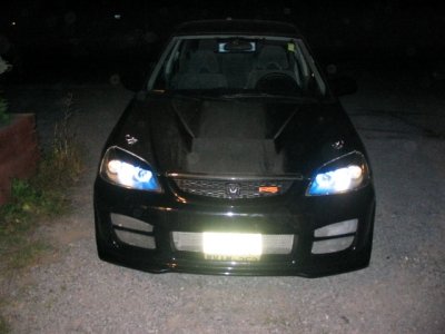

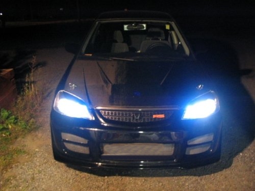

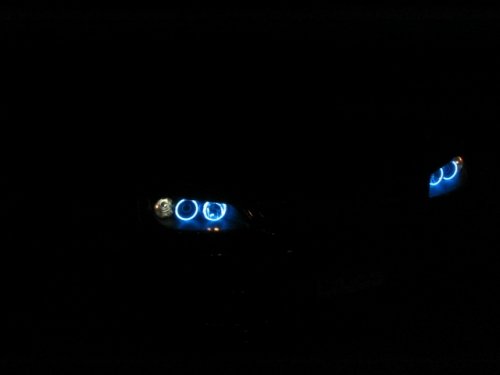

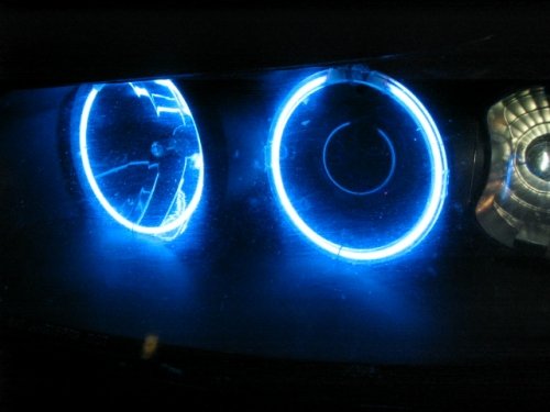

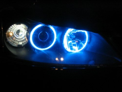

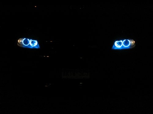

this is way brighter then the LED angel lights I donno how long it will last but dam rite it looks good
With just Ring on
with Ring on, lowbeam on
with Ring off, lowbeam on

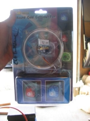

I used four of this Roung Cold Cathode Fan neon lights by Sunbeamtech all had diameter of 80mm and you can find it in the computer store

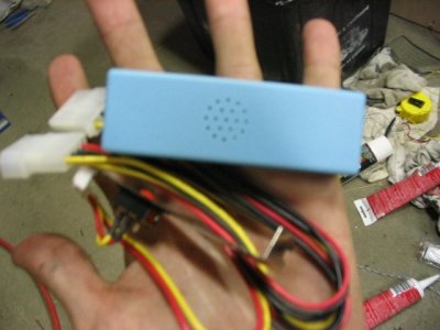

since computer parts and our car uses same 12v there wont be any problems with converting voltages this kit includes a fan(not needed), neon, switch(not needed) wires, and inverter
I used four of this neons

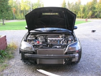

first take your bumper off and so as your headlight

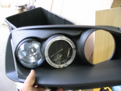

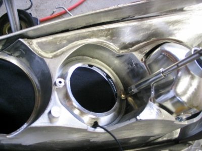

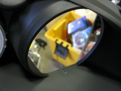

take your headlight apart and you will have this part on your hand
screw off the original LED angel light

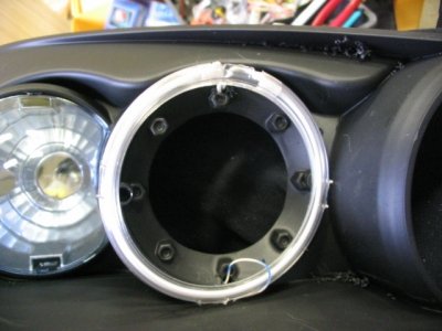

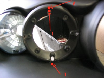

drill a small holes into red dots

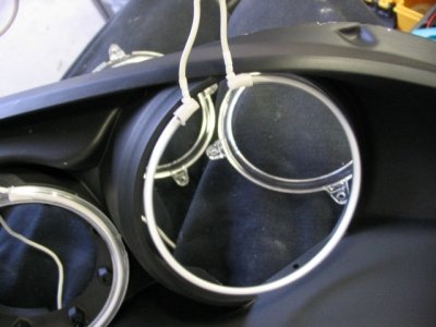

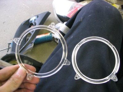

cut off four edges of plastic cover to make it round

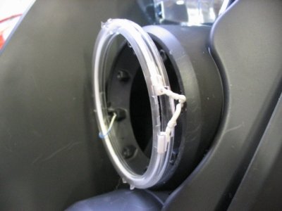

put the neon ring on, get the wiring out to the back and hold the ring with wires

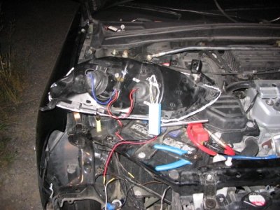

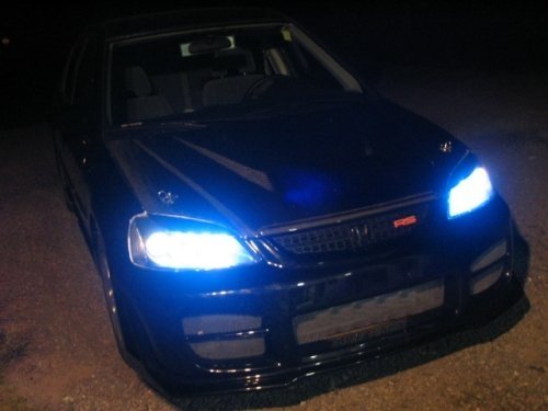

put back the headlights,seal it and connect it to the inverter
do the wiring and you are ready to rock

I wired it to sidelights so it will turn on when I turn the sidelights on and I also have a switch connected so I can turn em on and off while driving
hmm no one tired this so I donno how long it will last.. I will let you know if it breaks

inverter is a thing that changes low voltage(12v) to high voltage(620v) which will light up the neons. it's included in the kit.

It's Still Good! Cold or Hot
but it seems sometimes it needs about 1~2 seconds of worming up before it's fully bright. hope it gets throught this winter!
