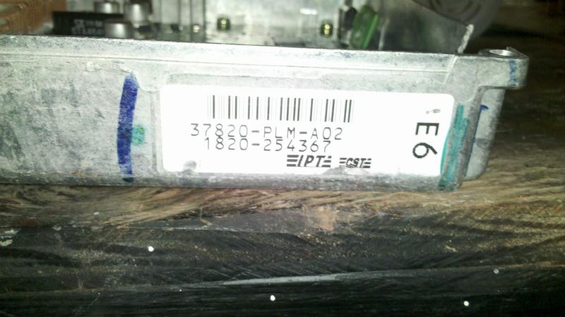

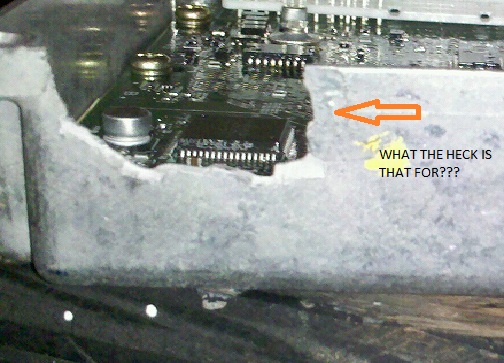

I will. So I pulled the ECU out and it has obviously been tampered with. There was a notch cut into the back side of the ECU but nothing in the notch. The wiring issue appears to be where wires were just located. there have been numerous hack wiring jobs that I have found on this car and to be honest this scares the sh*t out of me with the ECU. Any way to test it to see if there has been anything messed with?

[IMG]file:///C:/Users/Kris/Downloads/70.jpeg[/IMG][IMG]file:///C:/Users/Kris/AppData/Local/Temp/moz-screenshot.png[/IMG][IMG]file:///C:/Users/Kris/AppData/Local/Temp/moz-screenshot-1.png[/IMG]
ID:	79874   Click image for larger version

Sometimes you need to cut a hole in the ECU to run a USB cable or something like that to plug in...

yeah but the d17 ecu can not be used for Kpro so what would they have needed a usb port for? should I just buy another? If anybody has a d17 manual ecu p/m me.

Just because it can't be used for Kpro, doesn't mean that they didn't have it hooked up to a dyno or another system.

I think they had an aftermarket piggy back on it and yanked it out. Other than kpro there isn't a need to notch that particular ecu according to the guy at the performance shop. As long as its not messed up I dont think it matters. It will have an AEM F/IC on it in the next couple of days.

you could check to see if it has a hondata s100 or s200, if so i don't think you need the fi/c. the two mentioned above "Fits inside the ECU. No external wiring" and look like this.
you do need to cut a hole for a usb cable inorder to tune. the stock ecu is untunable without such modification. so there is a good chance a chip like this one is in there. find ut because they're worth a good bit of money. i was going to get one but they don't work for autos.

The guy at the performance shop is right, there is no point in cutting a hole for a usb cable in an untunable ECU, but that doesnt mean some genius didnt buy one of those fake performance chips off ebay or something like that.

Has that black IC chip been installed by someone? Is that what your pointing out in the original picture? That looks similar to 'chrome' tuning. Burn the chip on the PC and install into the ECU.
I wish I had the code for that modchip that mac25 pictured. The raw product is worth about $4 and I own a PIC progammer
