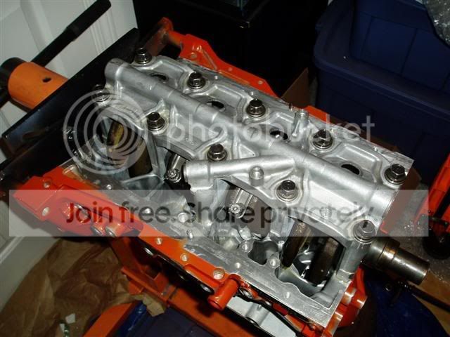

More progress....
Rods in
Crank Bridge on...
Pumps on...

Well... I got head.
Then after curing a minor whoopsie that was a pain in the *** to fix (I realized when I got the head back the pistons were 180 degrees off.... had punch the rods and pistons back out, flip the piston over on the rod then put the bottom end back together. Major pain.) For future reference, the narrow valve reliefs are for the INTAKE, and the wide ones are for the EXHAUST.
Now its ready to rock
It got head
TDCed and Belted
Ladies and Gentlemen.... Its built. Just the minor things left to close up... the water block, the accessories, etc... then its ready to drop in the car and cause some serious surprises.
