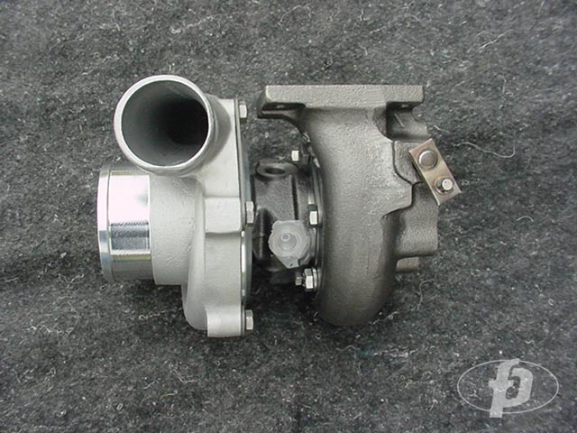

i got the tsi kit.... i have an oil leakage from the oil inlet.... this is what the t25 oil line inlet looks like... i have been trying to fix this problem for a while from different kinds of seals to j & b weld... nothing works... and i cant find a replacement.... i think dezod has it but i have to take my turbo off again (after taking off like 7 time) to take a pic so they can see if they got it...i have been trying to reach the vandor who sold it to me, still nothing... streetlevelperformance.com
i guess i need to contact tsi... but dont have their phone number... some one hook me up with the number or ideas to seal this bitch!!!!!!!!!!!!! THanks

that looks like a GT series turbo.
Anyways, its a 1/8 NPT fitting. Tapered thread, use teflon tape or paste and tighten it down.

if its leaking at the fitting from the engine or at the turbo, use teflon tape and tighten sufficiantly.
if you have been driving around alot and its not getting oiled your turbo might be damaged.
