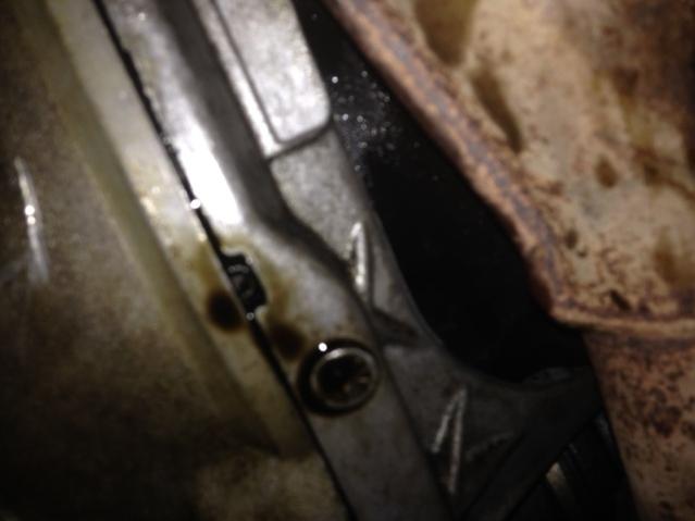

I need some help to figure out whether I have an oil pan leak or rear main seal. There is oil at top of pan on driver's side. However, the bell housing connected to engine housing has a separation in it and a square notch that drops of oil are draining from. I don't understand why there is a gap between these two housings. There is a bracket that connects to the bell housing and the engine and it is tempting to want to disassemble, but I don't want to drop components from their assemblies without having a good idea on how the subassemblies fit up with each other.

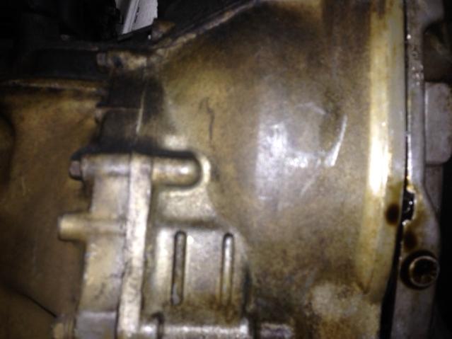

I've posted 2 pics. the one with the exhaust pipe, the black is the oil pan and shows the fit up of the bracket with oil seeping through. this is the most descriptive pic i could take on my back under the car. Any thoughts would be appreciated.

I see the oil streak on the bottom of the pan in the first pic., but it also kinda looks like its oil stained all around the bottom of the engine and trans (or lousy pics??)
I'd probably get some brake cleaner and clean it all spotless, even spray up into the bellhousing area, clean off from the top down......then give it a drive and try to see where the leak begins. Leaks from the top such as VTEC solenoid and distributor, etc., would end up at the bottom of the bellhousing too.
Coating everything in white powder may help as a leak tracing agent.
However, if you can let it run and watch oil dripping out of the bellhousing and nowhere else above....then it's probably a rear main. (or maybe the rear of the oil pan)

Thanks for your feedback. Look at the rectangular notch where both mating parts come together. I definitely saw oil dripping out of that rectangular notch with my own eyes just after starting up the car to establish oil pressure.
this is what i am calling the bell housing - although i am not sure that this is the bell housing. there is a kind of u-shaped (more square than u) bracket and i am not sure if the oil is coming from the rear main seal.
Does the fact that the oil is coming from this notch mean it is a rear main seal leak or is this notch created because of how the bracket mates to the housing?
Still not sure how to interpret this. Open to any thoughts. Thanks again!

The bellhousing is the area that contains the flywheel, clutch and throwout bearing and fork (manual trans) or the torque converter on an automatic trans. It's basically a somewhat hollow area between the engine and trans.
The cast bracket is probably used as both a support or stiffener and a shield to cover up the flywheel. I think it's held on with maybe 4 bolts but I don't remember if there is other stuff in the way of getting it out to look inside the bellhousing area easily.
If it's dripping oil out while you watch, that's a rapid leak IMO. Any oil leakage within the bellhousing area should end up at the bottom, where that hole is.
It could be rear main seal or oil pan gasket....(I've been fooled by the oil pan gasket before LOL)...or something strange and unusual.
Pan gasket is a hell of a lot easier to replace IMO than pulling the trans and clutch off..... so take that into consideration..
Has someone recently replaced the pan gasket? How long has it been leaking? Did you just get the car and don't know anything about its history?
