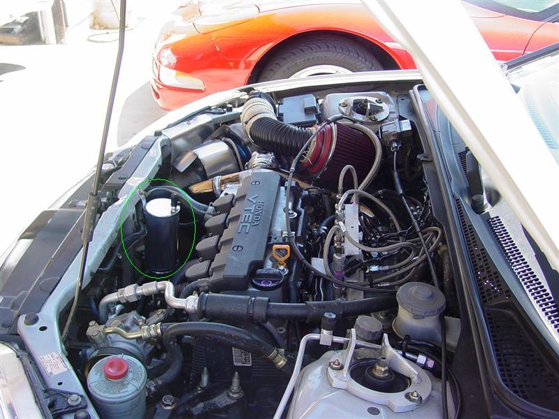

hey, what this do?

yeah really what is that?

oil collector?

No. It is the surge tank for the radiator. I had to take mine out to clear more room for my downpipe. So i made a nice aluminum one. It holds the same amount of fluid as stock.
also, my boost has fallen down to about 4 psi. the wastegate isnt opening. Im not hearing any more exhaust leaks, so i believe i have some boost leaks. This doesnt suprise me though. I am still waiting on several proper couplers. I am waiting on 2 2.25" couplers and 2 2.5" couplers. Right now i am using the 3" couplers you can buy from autozone on those. So im sure they are leaking. But i will get them fixed as soon as i get my new couplers.

the only thing normal looking about that engine bay is the wire cover and the power steering stuff looks sweet and i like the metal coolant resevior too.

Turboengnr, I was thinking. Since you don't have ABS on that car, Why not put the air filter in that spot and run a tube behind the IM and to the compressor housing? I may just be talking out my ***, but I went out to my car and you might possibly be able to do that. Here's a rough drawing
Attachment 65708
Sorry if this sounds retarded to you, Just a brainfart I had looking at that pic...
Attachment 65708
it would almost be like a cold air intake.. the only problem that i see in your design is that he would have to loop the steel braided fuel lines over the tube or build a narrow 2" pipe that would clear it....
plus there would be some air lag because of the length of the tube from the turbo to the other side... it's like going snorkling with a 4 foot snorkle....
the car has a hard enough time making boost now, i think with the longer intake, even if it's turbo charged, would make make it a bit more difficult to hit boost toward the bottom and middle end of the power band...

The length of the air intake tube is very crucial. Turbos have no problem blowing through piping. But they do not like sucking through them.
