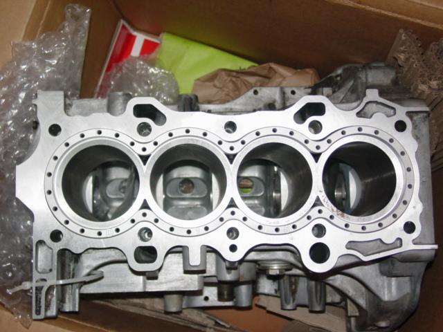

turboengnr's Avatar
DONT PANIC
Joined: Dec 2004
Posts: 2,201
From: California, Palmdale
Rep Power: 286
turboengnr is a name known to allturboengnr is a name known to allturboengnr is a name known to allturboengnr is a name known to allturboengnr is a name known to allturboengnr is a name known to allturboengnr is a name known to allturboengnr is a name known to allturboengnr is a name known to all
i love this picture!!!
Name:	sleeved block 007 small 2.JPG

  #90
def01tones's Avatar
You bought a used dog??
Posts: 608
From: Merdead, CA
Rep Power: 282
def01tones will become famous soon enough
that pics IS fvckin awsome!
im gonna try and get ahold of webster of websters dictionary and have him put a pic of u and ur car next to the word sleeper. ur car could not define the word sleeper any better then the definition itself.
u better quote me on that!
