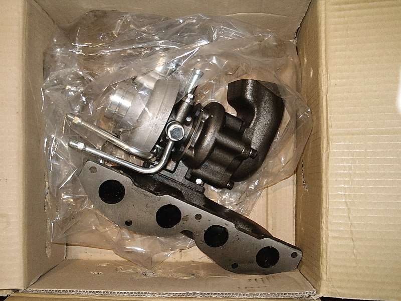

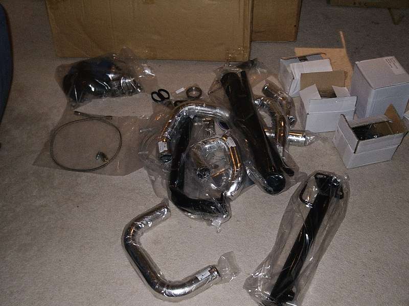

Yes it is here. Plans to go boooooooosted slowly comming together. Its regular T25, comes preassembled with many. This whole thing is heavy man!
The whole kit is in 2 large boxes!
3 pics: turbo with mani and downpipe end, set of parts, cat Chpoky who hepled to unwrap all things (rectangular box is IC).
It looks like I dont have to weld the oil return nipple. Its all like bolot - fully.
Looks like I need manifold gasket, its not in the kit.
I want to know if I need special tools for "home" install?
I've heard about mani nuts tightening, is there?
Anything watch out for?
Any basic turbo prep?
Other tips?

First impressions are positive. kit looks good, quality of parts, well, welds look ok. turbo spins freely, no play

Electronic connections instructions suck as*!

What is the size for the intercooler piping and charge pipe?

Be careful with oil lines thats something that must be done right

I got the TSI Extreme and mine was in one big box.. the caution is for the oil lines and wiring its not very clear but you will understand it once you get a good look at everything.

2", the sticker say its for t25.

TSI is a pain in the *** to install.

You do have to tap your oil pan for the return. they give the fitting, but you need to weld/jb weld it in there after drlling a hole. And do not use the rubber braided return line. get a steel braided line. my rubver return line is soaked in oil right now. not good at all

Fvck, I though I could use just the bolt on nipple for oil, I dont have welding machine...or may be I doo....I will see, but temporaty will just hold as a bolt on? Can you then just weld the nipple w/o taking oil pan off?

You use that to get oil to the turbo. You have to tap for the return line.
Its not that bad. You just need a drill and jb weld.

oh, and j-b weld comes in a tube. You mix up these 2 substances, and it forms a weld bond. Not nearly as strong as a good weld, but it does the job. Thats what I used, and its holding up fine. I checked it out the other day while I was installing my clutch/breaking my car.
You can buy it at any auto parts store and its probably like 10 bucks?? No welding machine or torches are needed.

My extreme kit was easy to install and needed no welding. After tapping the oil pan we installed the fitting with the washers etc and installed the braided lines.
