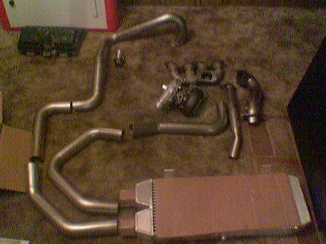

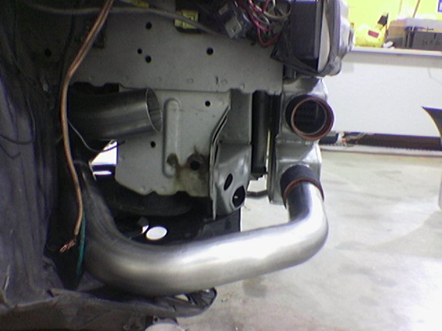

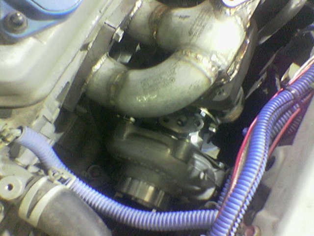

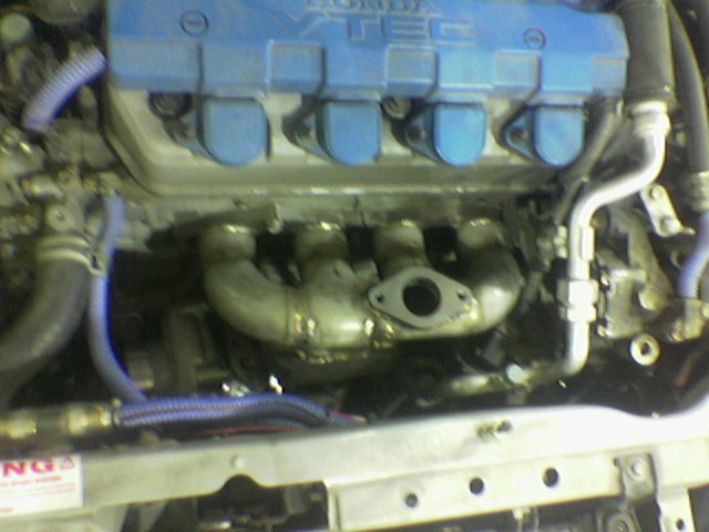

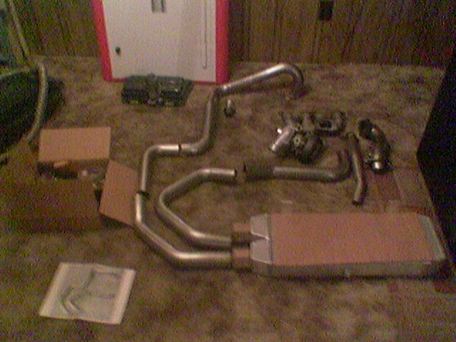

Oh i also forgot about one thing, that kit is and was designed for a carb emissions vehicle and not federal so the downpipe wont work right unless they have fixed that and it doesnt come with fuel stuff they did send me a fitting for a steel oil pan and not aluminium, umm comes with a big turbo that may or may not be the best for our cars or setup that whoever is going for w/o a built engine, oh ya the kit does not come with a dump tube in the base kit its extra and that is just the tube which will end up in your fans and it dumps to atmosphere and it was designed off a civic with a close coupled cat which also has all the a/c lines tucked away which a federal does not, all in all i would'nt recomend the kit for a street car or definatly not a bolt on at all and i would only use that kit for a big project and built engine, otherwise i would get the tsi kit which basically bolted right on.
Apparrently since going thru this with me they have been working on the kit and modifieing the kit to work better on a federal, but it will def not be a bolt on kit, its about a week long project at a shop.
Oh here is a pic of the kit out of the box with the optional dump tube.
